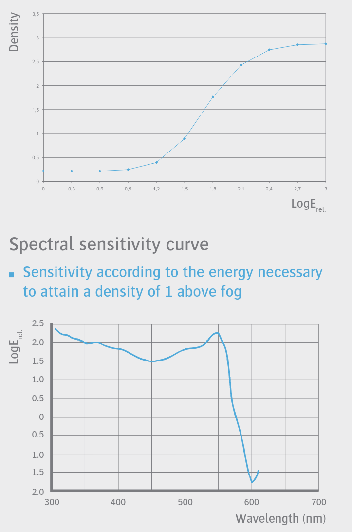

Hi everyone,
Hopefully a straightforward question - if you are using orthochromatic film for separation negatives of a colour transparency, can lower red sensitivity in the negative be compensated for by exposing the negative for a longer time to build density? I know this would require a lot of testing to prevent colour shifts, but in theory is this even possible? This is the response curve of the ortho film I am working with:

I'd say so yes. One thing I'd check for a minute is overlay the sensitivity plot of your ortho film on top of the dye transmission plots of your color film, but I'm pretty sure there's plenty of 'red' information in the section where the ortho film still has sensitivity.
What I can NOT vouch for is linearity of the H/D curve of your ortho film in the part of the spectrum you intend to use it. I'd expect some trouble there, with cyan/red crossover in the final work as a result. You'd have to experiment.
Kudos for trying to do this the hard way! What's your process/application exactly?

Thank you @koraks. Trying to get into carbon printing without using a computer / scanner / printer (just a preference). Because of Customs, I am only able to get x-ray sheet film locally. I am trying to decide what makes sense before I embark on any testing to arrive at a conclusion that others knew for a long time 😅. I believe I have everything else to be successful but while reading through Colour Photography in Practice and Modern Carbon Printing, panchromatic specialist films are what the authors recommend for carbon printing when working with separation negatives, which makes sense.
As a FYI, my goal is not to match / outperform any currently available process (including inkjet) or have perfect colour accuracy. So a few compromises here or there is fine so long as I can have some control over where those compromises are made (if that makes sense).

Might as well be attempting to stop a charging water buffalo with a BB gun. The short answer is, NO. You not only need a real panchromatic film, but ideally, a select pan film with the most appropriate linear and spectral response with respect to tricolor filtration. Otherwise, you might as well be jumping off a diving board with only rock below. Red is at 650mm; and you've already crashed well before that. Ortho and ortho litho are deliberately engineered NOT to see red.

Thank you all for the guidance. I won't go charging ahead as the comments confirmed what I was reading. Its a lot to think about, but at least I wouldn't have been coming from a negative, but a transparency. There is a lot here to consider, but is there even a panchromatic sheet film, available today, that is considered good (or serviceable) for separation negatives of Kodak E100?
