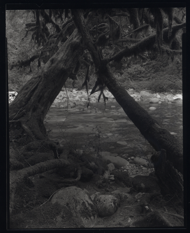

I used up the last of the tissue I brought home last night. Got one reasonable print.
The longest exposure was as long as the ones that wouldn't peel last time, but this time I used a fan, took a bit longer in the transfer bath, and waited longer (5 min) before trying to peel. None of them refused to separate.
Here's the best from last night.
I'm about to go camping for a couple of days. Hope the rain stops and I'm able to take some shots that I can overdevelop for carbon prints.
