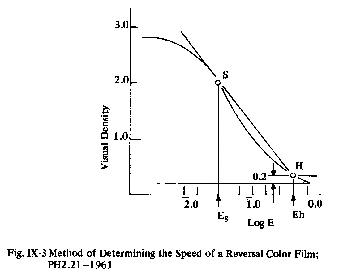

This may help:

Here are some answers, I hope.
1. Change in density / change in logE gives contrast measured as a straight line in the middle and straightest portion of the curve. This is easy with papers and negative films (which should have a long straight line portion) but more difficult with reversal films which are often quite bowed (see post above). The more bow in reversal, the lower the perceived contrast of the image, and so you can get quite good results with a variety of curves.
2. I'm not sure of the Stouffer product names. Sorry.
3. Speed can be measured in a variety of ways. The graph above shows the method for reversal which can be quite different for neg-pos systems. One true measure is the threshold speed of the emulsion which is the inflection point of the curve from Dmin in a negative. This is mainly invariant and only varies under special conditions not often observed. When one says that they have gained speed from a push, they have only increased contrast. A true speed increase might come by a sharper toe and normal contrast. In reversal, as we see above, the shoulder is quite bowed, but if you were to draw a straight line from Dmax where the inflection takes place, that would be the speed point. Ideally, higher reversal speed would take place at the same Dmax with either a sharper curvature to the shoulder, or a higher threshold speed.
All of this is spoken from the POV of a product builder, not a theorist.
I hope this helps a bit.
