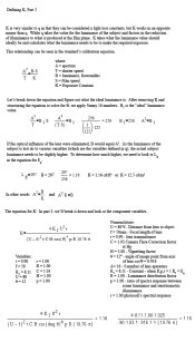

From "Is the K factor relevant to me or should I cancel it out?" thread.

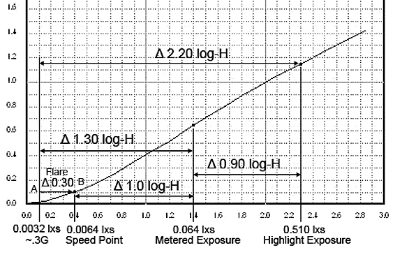

Here's a graph showing the standard model of how the scene luminance fits on the characteristic curve. The log-H values are for a 125 speed film.

Metered exposure to ISO speed point = 1.0 log H? Not 1.2?
That's what you'd get from the ratio of Hm=0.8/ISO and P=8/ISO. Not that I have any citation/justification for the latter formula other than posts in this thread.
I'm surprised you don't remember either thread. The 1.0 ratio is the reason why there's a consistent discrepancy between ISO speeds and Zone System EIs.
The proof for the ratio is with exposure meter calibration and how it relates to the metered camera exposure point.
Bill Burk
Feb 9, 2010
9,500
I see how this discrepancy (between 1.2 Zone System and 1.0 ISO) can explain 2/3 stop (of the 1 stop typical) discrepancy between ISO and Zone System speeds...
Zone System: Meter Zone V, stop down once Zone IV (0.3), twice Zone III (0.6), three times Zone II (0.9), four times Zone I (1.2)... where you expect 0.1 density speed point to exist on Zone I (four stops below metered point)...
versus
ISO: Meter, stop down 1 stop (0.3), 2 stops (0.6), 3 stops (0.9), 1/3 more stop (1.0)... where you expect 0.1 density speed point to exist at 3 1/3 stops below metered point.
Tell me... That's why I shoot TMY2 at 250 instead of 400... It's that simple?

There are a lot of variables that combine to make K. The K factor thread really goes into detail on this. In a nut shell, many of the factors have to do with the physicality of the meter and the camera optical system. But no matter what the value of K is, the exposure is intended to be 8 / ISO.
Here's a page that introduces the equation for K and if you're wondering about where the value of 8 in 8 / ISO comes from, check out the value of K1.

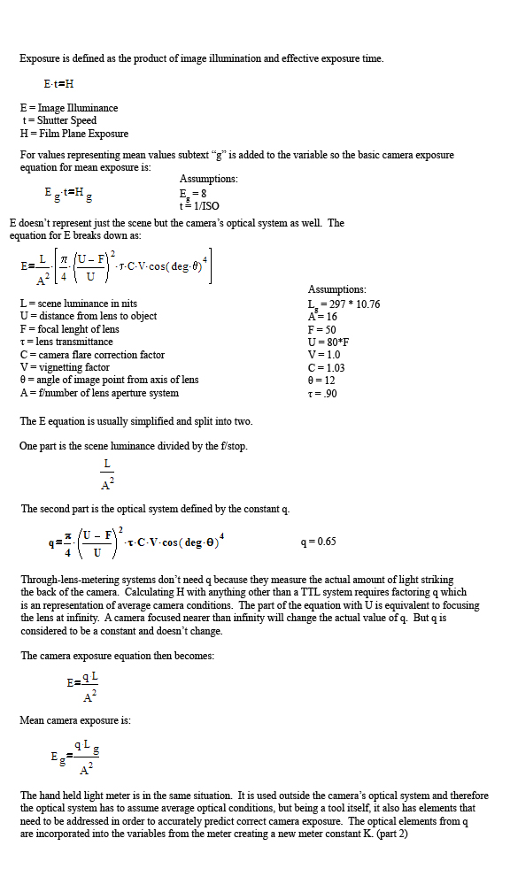

I forgot to mention that the equation Eg = q*Lg / A^2 equals approximately 8. This is the same thing as Sunny 16. Eg * t (shutter speed) = Hg or Hg = 8 / ISO.
