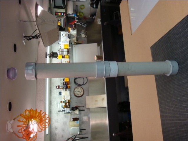

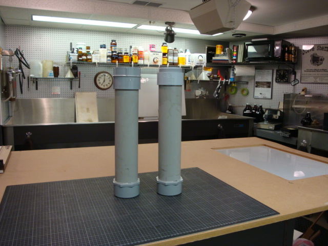

Hopefully 2 pictures of my developing tubes are shown here.
Initially, the film is loaded and then a presoak for 3-5 min. Chemistry is contained in the second tube and in total darkness the water is dumped and then the tubes are screwed together and turned upside down and the chemistry rushes into the film side.
Agitation is done via a rolling method for a minute or more depending on degree of development desired.
Tube then stands without agitation again for varying amounts of time predicated on desired development.

What are the diameters of the tubes Steve? They look like 3 inch diameter.
My goals is to fit as many tubes into a 5 gallon bucket as possible.

Yes, tubes are 3" diameter, they are electrical PVC conduit which is light tight where as white PVC is not light tight.
Tube depth is 3/4" longer than film length allowing forefinger and thumb to grasp the film in darkness and pull out to next step.
Good friend Tim Jones (climbabout) is the fellow who dreamt up this tube design and develops his 8x10 film with slight variations on my procedure and get terrific results as well.
