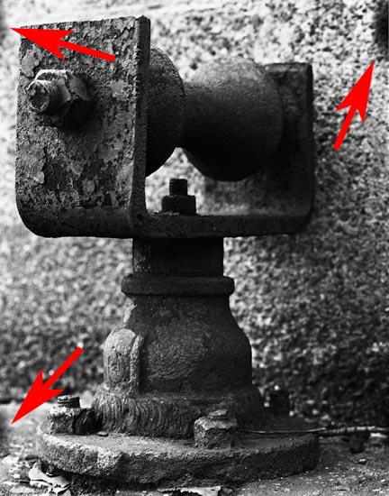

I did a 3 minute presoak. I actually always presoak my film, so that I get more even and consistent results, and my film is up to temperature before I pour in the developer. I at first thought it might be fingerprints, but it isn't exactly in the corners, and no fingerprint patterns show. I have highlighted the problem spots with big red arrows in the image below. I'm thinking it has to do with the design of the rack in the agitank, the more I look at it. I might be able to modify the rack by cutting out or at least minimizing some of the crossbars.

Looking at the scan I am thinking whatever method you are using to hold the film is causing unwanted pressure at the corners of various sheets of film and not allowing developer to produce uniform density.

I agree. Upon consideration, I think that it is the design of the film holder for the agitank that is causing blocked flow at certain points. I'll probably have to revert to tray processing (which is a pain because I won't be able to leave my darkroom or have lights on for an hour). I've always had very consistent results with the agitank before, which I know a lot of people don't, but I have a very gentle agitation method, holding the tank with my finger tips pointed up, just under the ridge around the top of the tank, and then rocking the tank, raising and lowering each corner in a circular pattern. Think Rob Gibson coating a glass-plate with collodion, and you get the idea, but faster.

I had no problem with stain - the stain was very even and consistent. I just had those odd under-developed spots in the sides of about half my film. I'll look into tubes - probably just bite the bullet and get the BTZS tube kit. When using PMK for normal development (1:2:100, 10-15mins depending on film) my negs come out of the agitank perfect - even stain, even development.
