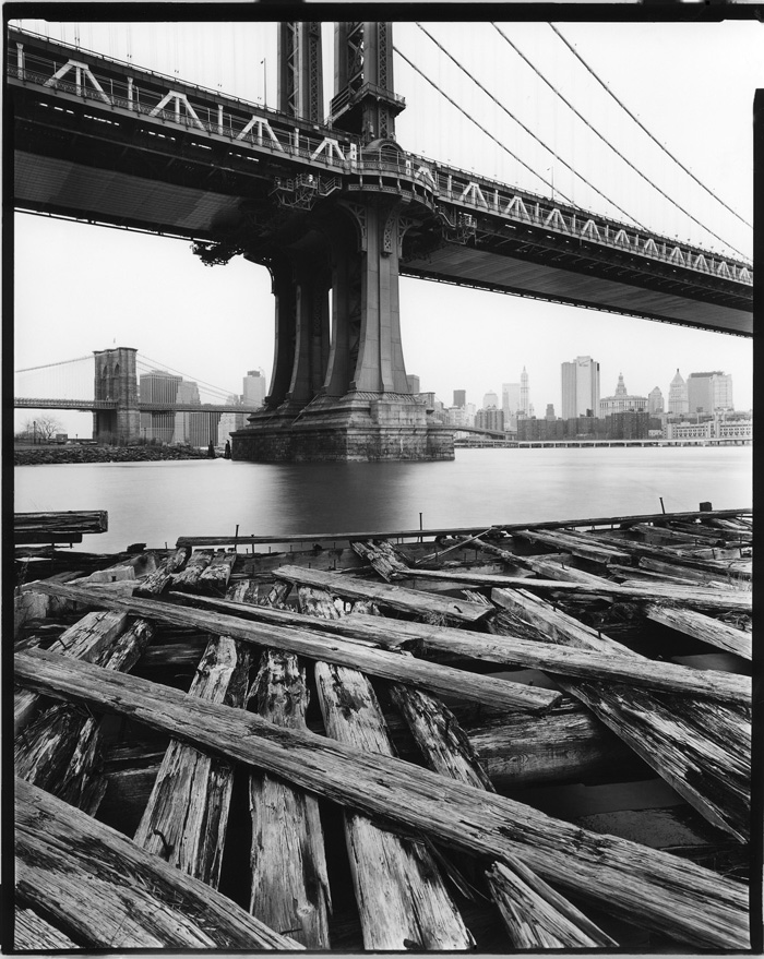

I’ve attached a file of a photograph I made for last weekends Semi-Stand Film Developing workshop at the Rockville Arts Center outside of Washington DC, graciously put together by Jim Shanesy and attended by 7 other photographers.
Rather than discussing the difference between developers and their respective chemical make up I would encourage those interested in the process to go make some negatives which have rich texture exposed in low contrast light and look for the obvious adjancecy effects but also subtle details which I will discuss below.
The file which I have attached is a completely raw scan of an unmanipulated proof print of the scene. The negative was made about 1/2 hour before it started to snow to give you an idea of how flat the light was at the time of exposure.
The text below is reprinted from a handout I gave to the students at last weekend’s workshop describing how Semi-Stand and Extreme Minimal Agitation film development impacts the negative.
Dark Values
Controlled almost solely by exposure, in the case of S-S or EMA development the dark values will realize maximum density as allowed by initial exposure.
Mid Values
Perception of mid tones is a product of micro contrast, micro contrast is the single greatest control is dependent on several conditions, scene contrast, film reciprocity, dilution and agitation frequency, stronger dilution, less agitation can be countered by weaker dilution and more frequent agitation, probably with slightly different results.
High Values
The densest part of the negative is controlled by all three, initial exposure, dilution and agitation frequency. Highlight’s appropriate density is dictated by the perception of tonality just below paper white with the product we choose to print with.
Looking at the photo of the Manhattan Bridge we can conclude that the dark values are controlled by exposure, the sky being the brightest area of the negative is dictated by the density necessary to render slight tonality, in this case on Azo. I was most impressed with the micro contrast which resulted in the far off buildings in the right hand side of the photograph. I pointed this out to the class, Jim Shanesy can attest to the fact that the clarity and perception of detail is startling.
I would concede that the micro contrast which is present in the weathered planks in the foreground is possible with conventional development even under these lighting conditions but the micro contrast which is present in all areas of the negative would not be possible without this technique.
My point in all this, I truly believe that the S-S or EMA technique works equally well with a number of different developers and to a large part negates the uniqueness of many popular films. It is truly the best of both worlds, maximum film speed and shadow contrast and by nature has a compensating effect on the high values all the while with experimentation you can derive any micro contrast in the mid tones you desire.
Go make some negatives!
For those interested in the image itself. I will be releasing a Limited Edition of this Minimal Agitation negative printed on Azo and mounted on archival board, complete with descriptive and technical notes. The edition will be limited to 100, is priced at $100.00 and will close after 100 days. Proceeds will go towards the construction of my new darkroom and classroom facility which is presently underway. The edition is scheduled to be released at the beginning of June 2006. Watch for more details on my web site.

Steve, thank you sharing your workshop results with us. I use Unsharp Masking on my 4x5 hegs that produce similar enhance edge effects. Realize this is not possible to discern using your Thumbnail. USMs for MF are to arduous so I don't use them. Here's where your approach would pay off. Semi-Staand I've done. My opinion is that FULL stand development would be needed to appoach this objective?
No matter how much I may attest, you have to see this print to believe it. The scan doesn't have even 1/10th the impact of Steve's print.

Thanks for posting this. Very interesting. I have recently been involved in a discussion with some photographers, who deny that edge effects can actually be obtained with S-S or EMA and that I will see no discernible difference with negs processed on my CPE-2 and its constant agitation. However, Anchell and Troop indicate in their book that constant agitation works against such edge effects, although they do say that this can be compensated for by using even more dilute developer (although looking at the numbers tank sizes may be an issue here). Would love to hear your opinion on this matter. I am keen on developing my B&W landscape photography further and would love to learn how to produce such edge effects when needed. I have read Barry Thornton who also recommends dilute Perceptol (1:2 or 1:3) although he uses standard inversion agitation as far as I can see.
By the way, I really enjoyed viewing your image. Very satisfactory experience.

The most recent upload to my gallery shows what an "edge effect" is. I did not intend to post the image as an example, as it was done with 35mm film (Efke 100 & minimal agitation to enhance sharpness). The edge of the wagon, where it meets the sky at the top of the image, shows this effect pretty well. While not a 4x5 shot, it does illustrate the relationship of dark against light. I find this is more pronounced where a dark area of the film meets a light area (where the thin edge of shadow interacts with the thick edge of light).
I was asked about this effect on one of my prints, as it gives the appearance of a "mask" with a halo. No masking involved, simply a benefit of minimal agitation and dilute developer. In this case, 1:1:150 with 3 minute agitation intervals and pyrocat. For anyone who hasn't tried this type of development, I would urge you to do as Steve has suggested. It opens up a whole new world of sharpness and depth which is just not there with the usual development process. tim

Micro-contrast and edge affects (same as adjacency effect) are not interchangeable terms, but they are intrinsically linked in that one is the cause of the other. That is, edge effects or adjacency effects are the primary cause of enhanced micro-contrast. [/QUOTE] [/QUOTE]
Sandy's description of the relationship between "Edge" and "Micro" contrast is right on target to my way of thinking.
Yes, I have read Mortensen on the Negative. My interested was piqued when a friend told me he had heard a story that Mortensen once developed a sheet of film for a week. The story I heard was that Mortensen put a sheet of film in a tank and agitated once each day and returned the tank to the refrigerator where the film stood dormant and repeated for 7 days. I actually tried something similar by developing a sheet for 4 days in my darkroom where the temperature hovered around 65 degrees. The result was a very dense negative with dramatic adjancecy effects. I do believe if the “throw away” negative I developed was exposed more on the straight line with the highest values purposely left in the middle of the straight line the negative
would have been printable, very probably with some very interesting results. I will try the above sometime in the future just for fun.
Mortensen basically reversed the long accepted adage "Expose for the Shadows and Develop for the Highlights". This is likely born out of the fact he did not agree or get along with the F 64 group, Adams, Weston to name a few and likely wanted to discredit their work. Further, I believe he felt by placing the highlights more on the straight line and giving maximum development, (he called it "Gamma Infinity") that the entire straight line would be exaggerated to reveal the most interesting tones which make
up a B&W photograph.
My development regime is a 5 minute presoak in a tray, transfer to tank with film in vertical orientation and agitate gently with a Jobo “cylinder cleaning sponge” in a gentle up and down motion. For one minute initial agitation I move the sponge up and down 25 times, for 20 second intermittent agitation periods I do the same motion 10 times. Circular stirring action has proved to be unreliable and has destroyed some of my earlier negatives. Once the scheduled time has elapsed I carefully transfer the film by grabbing just the edge with my fingernails to a tray of diluted stop bath for 30 seconds and then into a non hardening fixer for 5 minutes.
I use Pyrocat developer exclusively and until I hear superior results with another developer wonder why anyone would use another product. Sandy King is the inventor of Pyrocat and has proven to be a wealth of knowledge easily assessable to anyone who frequents these forums, seems to me to be the easiest part of the whole process.
As far as those who claim there is no evidence of increased micro contrast, they obviously have never even seen a print from this type negative much less done the process themselves. My father used to have a name for those types, had to do with paper and ones's posterior.

Steve, your photo didn't show me anything until I printed it. Even on ordinary bright white typing paper, it is very striking. I am very jealous.
You didn't mention the film or developer. Did you perchance do the same scene with continuous agitation?
I have read in some technical book that these effects are considered defects of insufficient agitation that are difficult to avoid even by continuous vigorous agitation. Viva la defect!
I have had some trouble with uneven development, which is difficult for me to predict.
I can't stop looking at your photo.

The film is old Tri-X, outdated 1994 film. The developer is Pyrocat diluted 24: 16: 4000ml at 66 degrees. Developed 5 minute presoak, 1 minute agitation, 12M stand 20sec. agitate, 12M stand 20sec. agitate, 12M stand out to stop bath.
I can't begin to describe the micro contrast in the buildings far off in the distance.
When I did the workshop last weekend it was in conjunction with a large show of all Azo contacts. The show is extraordinary, five very talented photographers exhibited 60 wonderful photographs. I looked deep into most images and we have all seen what happens to small details far off in the scene, they just seem to fall apart, lack any sharpness or contrast, but that is what we are used to. Until Semi-Stand came along, if you have never tried it, please do so, if you are close to Washington DC, please see the show. I understand the entire show will travel to Louisville and spend several months.

I still have undeveloped film of that scene which I plan on processing with continuous agitation for a side by side comparison.
In the workshop I showed a number of negatives with higher density indexes measured on a densitometry which were tray processed with continuous agitation which printed too flat, remember the scenes I am talking about have approximately 3 zones of literal contrast. Semi-Stand negs processed to lower densities printed with extraordinary micro contrast. I can not stress enough this process is the best of both worlds!
It's hard for me to talk in extraordinary terms about my own work. All I can say is you really have to see my originals to fully appreciate them, many times I am still surprised to see some of the results and the fine nuances which are revealed.
When Michael Smith saw them he was stunned, he called to Paula to quickly come and see first hand! What more can I say.
