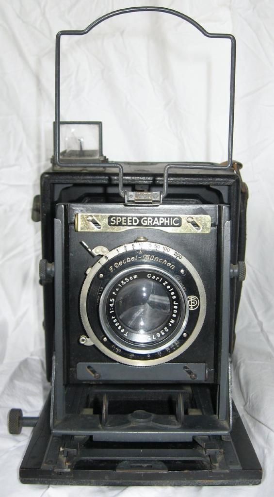

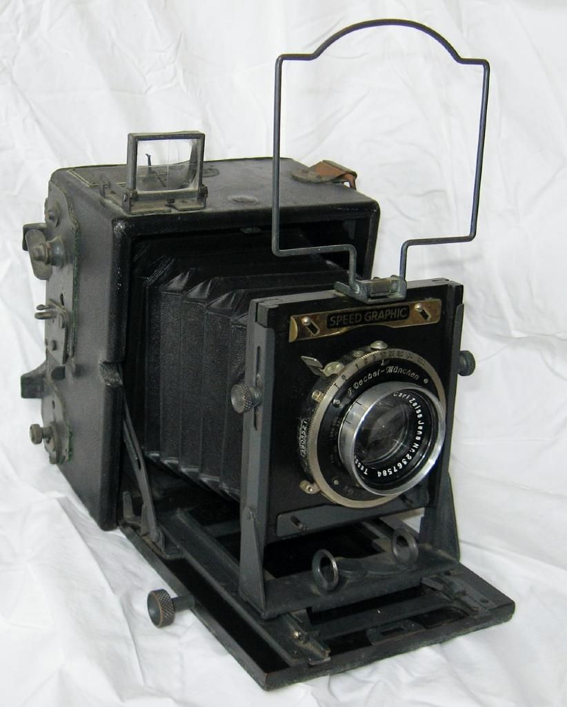

Hi all. Newbie here. I picked up a Speed Graphic camera in my travels and wish to sell it, but I want to make sure I do it right. I'll admit up front I know very little about the mechanics of vintage cameras so even though it LOOKS to be in very good condition, I'm not sure what I'm looking at.
From the research I did online I believe it's a "pre-anniversary" model (is that from 1928?), and what I also found interesting is that it has a Zeiss lens. The leatherette piece covering the back has come off (and can be re-glued) but other than that I can see no immediate issues.
I'll post some photos, and would love any input from the experts out there on its value, the best place to sell it to get the best price (I assume ebay, though I could also sell it privately), and what I ought to check as far as condition. Are people comfortable buying these "as is" and knowing they may need to do some repairs? (assuming the photos are thorough). Obviously I can't test it out.
Also, what might this bring? It seems that $300 - 450 seems average on ebay, but I wonder if the Zeiss lens adds to the value? Thanks so much.

I'm sorry but that camera need major work. With the lens I would say 50-75 maybe a little more for parts.
hokeypix
Nov 15, 2009
6
Can you please be more specific? What "work" does it need?
PBrooks
Nov 14, 2003
184
ULarge Format

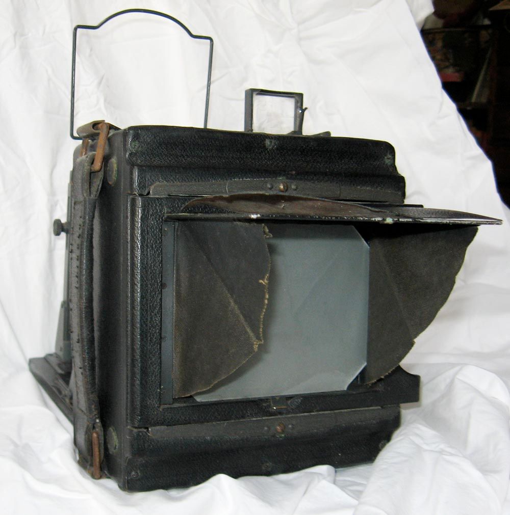

Well, first all the rust. Second, the bed rail looks warped. It may not be but looks that way in the pics. People normally buy these for a working focal plane shutter. Does it work, I am just guessing here but the inner workings are probably as rusted as the handle loops. I does look like a good candidate for a restoration and some people love to do that.

The most desirable Speed Graphics as USER cameras are the Pacemaker Speed Graphics with Graflok Back. Next are Anniversary Speed Graphics. Any Pre-Anniversary Speed Graphic is considered to be more of a collector camera rather than a user. There are still a lot of these Pre Anniversary cameras around, so yours is really not that rare. If you happen across a Military model, it would be more valuable.
Another point that has not been mentioned is that 3 1/4 x 4 1/4 cameras are considered to be less valuable than 4x5. If you happen across a 5x7 Speed Graphic, It could be somewhat more valuable. I would agree that the auction value of this camera as around $50-75.

Speed Graphics vary quite a bit in value depending on the model, age, condition and accessories. A recent comparable pre-anniversary (with Zeiss lens) went for $56 on ebay (auction #320445141337). You might get a bit more, but maybe you'd be happier keeping it and using it.
k_jupiter
Feb 3, 2004
2,569
san jose, ca

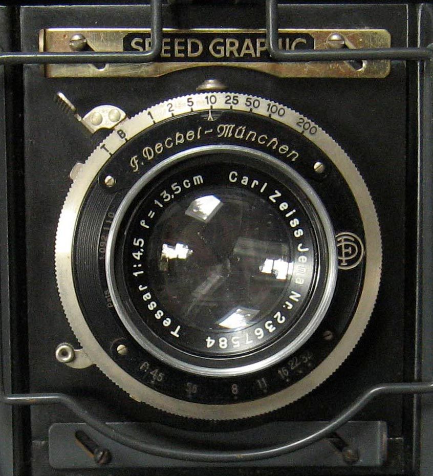

First off, it is a 3.25x 4.25 camera. It has a lot less value than a 4x5. That is a nice lens on it but uncoated.
50 to 75 bucks. Makes a nice mantle piece.

Will that lens cover 4x5?
I have one which does with just a bit of movement. In theory and according to the specifications, it shouldn't and was usually supplied with european 6x12cm plate cameras (which is where mine came from).
I think it is more of a sharpness in the corners issue rather than light fall off though.
Steve.
Ian Grant
Aug 2, 2004
23,414
West Midland
As Steve says the lens covers 5x4 but sharpness is poor at the edges and corners until f16 and at it's best at f22, which Zeiss stated was the optimum aperture. There's no discernible light fall off at the corners and the lens (if in good condition) is capable of surprisingly high quality if used carefully.
The shutter on that model is very easy to repair (I over-hauled & repaired one last year) and there's even patterns etc for making new curtains available online.
The shutter itself is worth at least $50 as they are very robust & easy to get repaired, more reliable than Copal's, $300 is perhaps a bit optimistic but if it's all functioning then it's possible you could get in excess of $200.
In the UK that lens alone is often listed at $1800-$200 by one Ebay store, not sure if they ever sell though :D

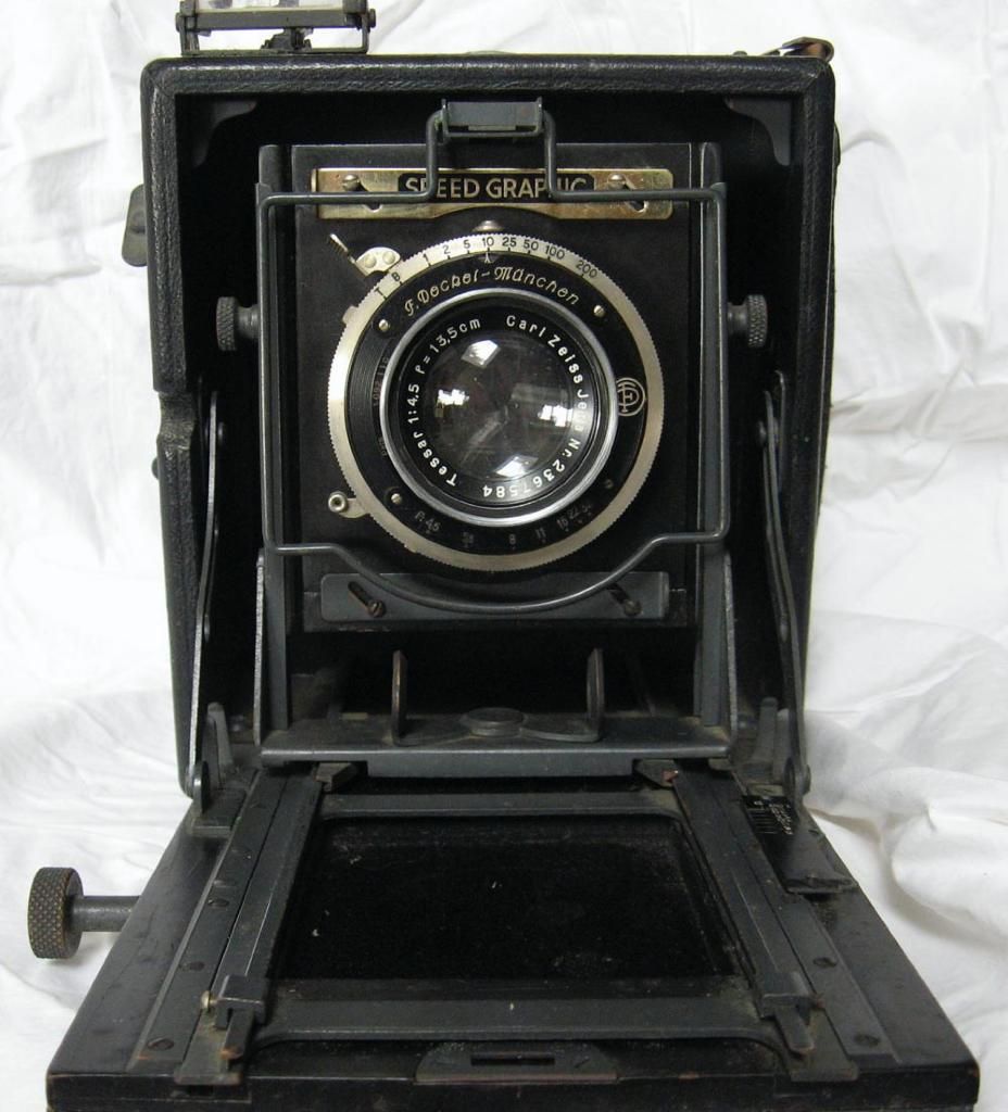

Thanks for the info, Dave. I followed your instructions and it did all that you suggested, quite smoothly. I could hear the shutter open at different speeds. Now that it's set on 6, how do I set it back, btw? Are there any other tests I ought to do? Btw, it also came with three extra backs - two look fairly modern, and one antique.

So is is a 3x4, then? If I were still shooting, I'd keep it, but I stopped shooting a while ago (my work is in a show that just opened at the Brooklyn Museum..) : )
I just opened the bellows up all the way and straightened out the bed until it clicked down (hadn't done that before - oops). I'm just surprised that a nice large format camera from 1928 would sell for so little. I mean, I paid five dollars for it, but I didn't assume that's what it sells for on the open market.

Let me repeat, that is one heck of a nice lens for B&W. I have one on a 1926 Zeiss Trona and it is sharp as a tack, even at f8-f11. @f16-f22, you will have problems telling it from any other really good lens.
But it is 3x4 and that will keep the market value down.
Shoot it, it's a nice format.
