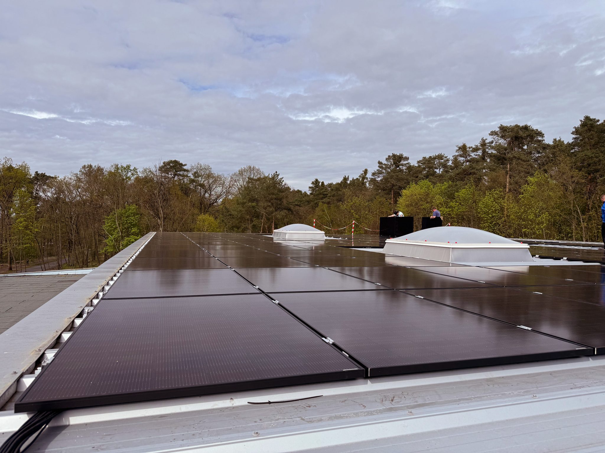

Two years ago ADOX and FOTOIMPEX started an investment programm to become independant from the public grid and in the mid term CO2 neutral. We installed a combined heat and power plant (blue energy in the long term green running on H2), a giant hot water tank, a 60 kWh buffer battery and today a 70 kW solar power plant on the roof. When all components are wired up we can basically cut the factory off the public grid.
In times when there is no sunshine we can run on the battery or the gas turbine kicks in. With the heat of the turbine we run the kettles and the general heating system.
The battery buffer is evening out the night-hours without sunshine.
Acording to our simulation we will be 80% independant with electricity over the spring-summer-fall period and achieve > 50% over the entire year just on the PV (100% with the remaining gas use).
Next to the environemental aspect this is ofcourse also helping us to control costs (energy prices got out of control in Germany).
Compared with the current electrical prices in Germany we will save more than 80% (the remaining 20% are the costs for the gas).
The setup was not cheap and we are somewhat pioneers. In the future the components hopefully become more affordable. We think this is the way to go foreward. The public grid does not have enough capacity for the green transformation as it is planned by our politicians and we cannot see how they will change this in short time. If every factory does what we did industrial CO2 emissions can be substantually reduced in short time and capacities can be freed for the citys where there is not enough space to install these things.

Good job for doing it, but I can't fathom how high your electricity costs must be to justify that large a capital installation. Here in the US, it doesn't even make economical sense for homeowners to install their own solar roofs, except in the highest priced markets. That's much of what makes the green conversion such a hard sell here.
We currently pay 59 cents per kWh due to a ripp off by our supplier who raised prices during the peak period. Before the energy crisis we payed 12 cents for years. Currently we can close for 3 months on 29 cents. This is all crazy!
What I like is the independancy. There are some maintenance costs but at least we are back in a planable state!

Germany is passed this state. We have a lot of renewable energy in the electrical mix but the problem is evening out the volatility (day/night and more importantly summer/winter). This is what puts the price tag onto our "fully self sustained" setup. If you have solar farms feeding the grid the question is which coal power plant can go up and down to compensate sunshine intensity. There is a limit onto how much renewable energy the classic grid with classic power plants can compensate. Your trees might not be so bad btw. Solar intensity is one thing but having to clean the modules from dust is something else. We are located in the forest which is perfect for the later.

Land should always be used for growing food if it is fertile. But in our case we have now populated only 1/3rd of our roof with solar cells and we already reach >50% of self sufficiency. This is somewhat a sweet spot in respect to investement and savings. We could go 100% but then we would need to feed substantually into the public grid in the summer which I consider counter productive from an environmental standpoint. There is no solution yet for the summer/winter volatility but in the countryside each roof is large enough to reach similar numbers like us if you combine it with a battery smaller than the battery in an electric vehicle. This does not consume any space used for growing food :smile:
I don't see why that would hold you back, exporting power to the grid can be controlled by the inverter(s). Essentially you have what we have on our house, photovoltaic (PV) cells on the roof and batteries around the property. When we first put PV on the roof, our system was small and we exported anything we weren't using. Some years later we added more PV to a couple of rooftops of our house and added 20kW/h of flow batteries. By this stage in Melbourne Australia, conditions had changed and we now are required to restrict our export possibility to 5kW/h.
As there is a possibility in the near future that we may be charged to export our excess power to the grid, we will just shut export to the grid if this happens. Currently we are virtually self sufficient between mid October to mid April.
Are your batteries Lithium Ion, or Sodium Ion? Our current batteries are hybrid flow batteries, if we add more batteries, I'm fairly certain we would endeavour to use Sodium Ion.
Regardless, congratulations on your efforts to help the world and at the same time, dramatically reducing your running costs.
