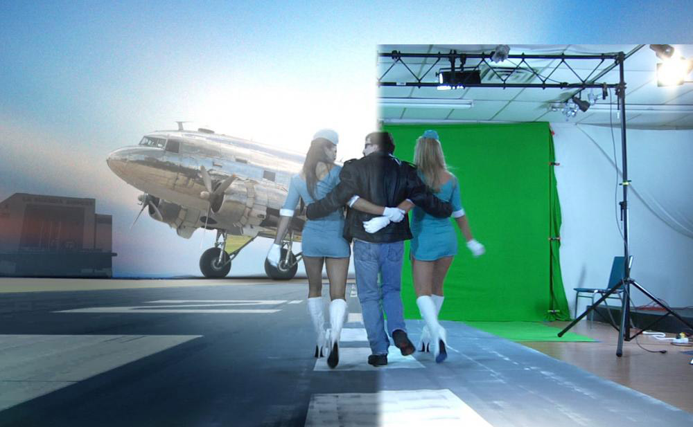

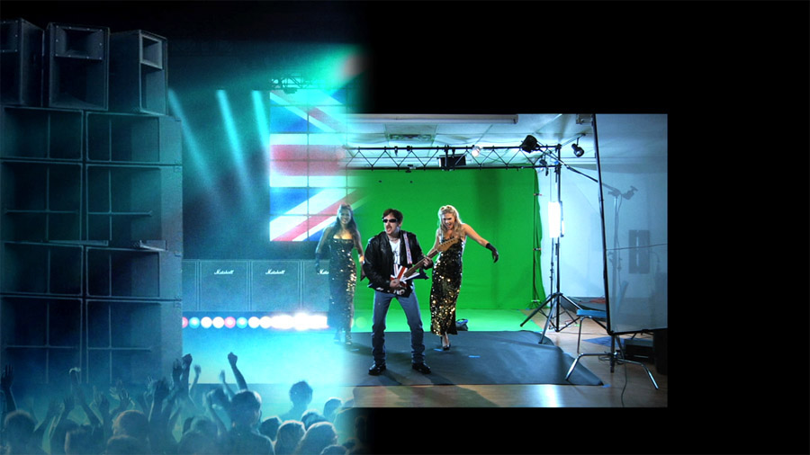

For putting layouts on a ground glass, I use static cling inkjet material (I also use this on monitors for video shoots, say we're shooting greenscreen and I want to make sure the perspective of the scene we'll add later is correct). You can sketch on it with sharpies or print more complex stuff on it. Best of all, it really stays put but leaves no adhesive on glass parts. (See the pics below, priceless stuff, esp. for product shots that have to go with a layout).
Other than that… 3d printing!!! Just made a registered glass carrier for a Beseler 67 (which never offered glass or registration). Currently working on getting a tilt-shift version of a flipped brownie hawkeye lens on a Nikon or maybe my RB. yeah, that's a little crazy...
