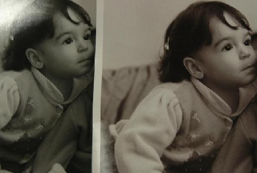

I toned last night using Paterson Acutone Selenium and I got a very noticeable tone change
I left the MC111 in selenium (1+7) for about 15 min... when I checked with a flashlight I could see a "reddish" midtones, so I left it there to get to the highlights which took another 10 minutes.
The final resul is very pleasing, as seen in the attached file (Toned on the right side)
