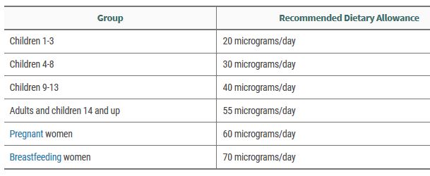

Following up on that, just for fun. Daily recommended dose 50µg/day (see below) from natural foods or pills. I live in a community of approx 3000 people, and would bet I'm the only one using Se toner; in fact the only one doing wet B&W prints. Collectively my neighbors intake (and excrete?) 150mg/day of Se. Last time I prepared T55 Se toner was 5 years ago, using 6g of Se. In the course of those 1800 days, my neighbors excreted(?) 1800x150mg=270g of Se.
I bet now I receive a broadside of angry and politically correct comments. Just before you jump to your keyboards: I drive a car with a 1.2litre engine; and thanks to selective waste disposal, I contribute under 20litre/week to the garbage collection.

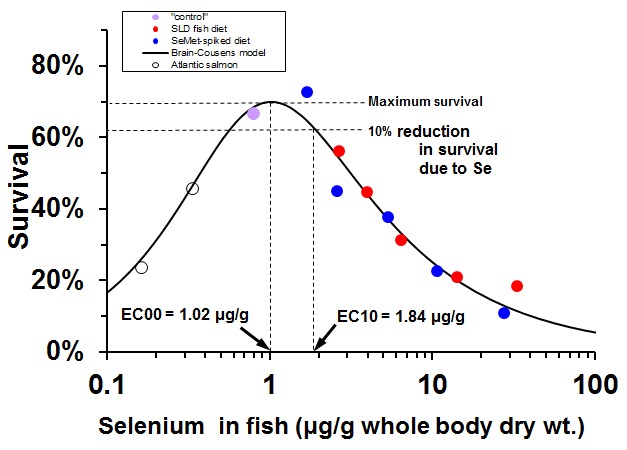

Selenium is a nasty chemical. It kills livestock, fish and birds. The line between needed levels of selenium and toxic levels is a narrow one. Found in the soil in various amounts, livestock die from eating the grass grown on soil containing high selenium levels, and human intervention in the movement of water can concentrate the selenium in the environment. Don't fear it, but respect it.
Filter feeders concentrate contaminates in the water. In Puget Sound, I suppose one should be able to get drugs and vitamins supplements galore by eating the shellfish. Prescribed (and street) drugs going thru the sewer system far exceed the amout of selenium!
