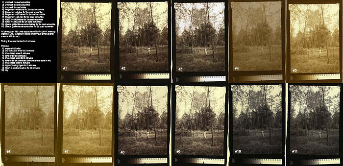

Today I ran several toning tests with Van Dyke Brownprint. The prints are drying tonight. I will post scans tomorrow if I get a chance but until I can, here's what appears to have happened:
1) Prints gained density as a result of toning in Clerc's Gold toner compared to other toners or untoned control prints.
2) Prints bleached heavily and fogged immediately when treated in Polytoner before fixing.
3) Prints bleached heavily in Polytoner if toned after fixing. These did not appear to have any appreciable chemical fogging.
4) Polytoned prints appeared to have lost wet strength as a result of toning. Stronger toner concentrations enhanced this nondesirable effect.
5) As the concentration of Polytoner increased, bleaching increased.
6) Prints gained contrast and reduced exposure scale due to bleaching action in KRST 1+500 regardless of whether toned before or after fixing. It appears more density was lost if fixed prints were subsequently toned than if prints were toned before fixing. (I'll have to check that tomorrow though to be sure.) This was a surprise to me as I thought the bleaching would be more severe. Extra exposure could probably make this workable contrary to what I had expected. There was a color change apparent in the KRST toned prints. I think they will appear to be redder than untoned prints when they finally dry.
7) Double-coated emulsions exhibited greater d-max after processing.
8) The ecruwhite paper printed with less contrast than the white paper. (See variables below.)
9) Prints toned in Clerc's toner went very strongly towards a cool purple-black color. Selenium-toned prints were much warmer and redder than gold-toned prints when wet. Polytoner produced heavily bleached, sometimes fogged prints with a much more yellow color and greatly reduced density. (If Polytoner is to work at all, I suspect the dilution must be much greater than tested today [e.g., perhaps 1+500 might work] and Polytoner should be attempted only after the prints have been fixed.)
All were printed with the following conditions:
1) All prints receiving a toning treatment were toned for 3 minutes in fresh toners;
2) All prints were double-coated with the exception of 1 single-coated print used for comparison;
3) All prints were made on Cranes' Kid Finish stationery ecruwhite with the exception of 1 print on Cranes' Kid Finish white used for comparison;
4) Wet times were kept similar for all prints.
Prints were given the following general treatment:
1) Exposed for 185 units on a Nu-Arc 26-1K mercury exposure unit;
2) First rinse in 2% citric acid for 3 minutes;
3) rinse in tap water for 3 minutes;
4) tone, or fix in 2 baths of 2% sodium thiosulfate for a total of 3 minutes;
5) rinse for 3 minutes (or until toner no longer bleeds from print in the case of Polytoned prints);
6) fix in 2 baths of 2% sodium thiosulfate or, tone for a total of 3 minutes (whichever was not done in step 4 above);
7) rinse 3 minutes in tap water;
8) clear in Kodak Hypo Clearing Agent for 3 minutes;
9) Wash in vertical washer for 30 minutes:
10) dry.
Prints were processed in 5 groups (i.e., untoned prints, Polytoned prints @ 1+4 dilution, Polytoned prints @ 1+50 dilution, selenium-toned prints, gold-toned prints).
The prints were:
1) untoned print, emulsion single-coated on Cranes Kid Finish ecruwhite;
2) untoned print, emulsion double-coated on Cranes Kid Finish ecruwhite;
3) untoned print, emulsion double-coated on Cranes Kid Finish white;
4) print toned before fixing using Kodak Polytoner 1+4 dilution, emulsion double-coated on Cranes Kid Finish ecruwhite;
5) print toned after fixing using Kodak Polytoner 1+4 dilution, emulsion double-coated on Cranes Kid Finish ecruwhite;
6) print toned before fixing using Kodak Polytoner 1+50 dilution, emulsion double-coated on Cranes Kid Finish ecruwhite;
7) print toned after fixing using Kodak Polytoner 1+50 dilution, emulsion double-coated on Cranes Kid Finish ecruwhite;
8) print toned before fixing using Kodak Rapid Selenium Toner 1+500 dilution, emulsion double-coated on Cranes Kid Finish ecruwhite;
9) print toned after fixing using Kodak Rapid Selenium Toner 1+500 dilution, emulsion double-coated on Cranes Kid Finish ecruwhite;
10) print toned before fixing using Clerc's Gold Toner, emulsion double-coated on Cranes Kid Finish ecruwhite;
11) print toned after fixing using Clerc's Gold Toner, emulsion double-coated on Cranes Kid Finish ecruwhite. (My SOP.)
OK, here are the scans. The single image is the exposure and treatment I consider standard for my VDBs. It also looks the best in hand.
Small arrows on the stepwedge mark the extent of printed tone due to the exposure, so you can see that the gold-toned prints actually gained steps, selenium-toned prints lost steps, and Polytoned prints stayed about the same in the highlights, but lost maximum density. For the untoned ecruwhite examples the highlight density stayed the same but the print on white paper lost a step in the highlights. The untoned prints are also the most reddish-brown of all.
There was a slight bit of variation evident in the exposures between the prints although most looked identical coming out of the exposure unit. The maximum variation was less than 1/2 step or 1/4 stop. Whether that was an artifact of the actual exposure or a coating artifact is unknown. It may have been due to a change in humidity over the course of the day, but it was rainy here all day so I doubt that was the cause. Papers were all coated early in the day and then printed throughout the day so some sat around sensitized longer than others. However, I couldn't detect any pattern over the course of the day that would explain the slight variations. I suspect they are ultimately attributable to small variations in coating.
Bottom line is that I prefer the gold toner treatment but the weak selenium toner also changed the color somewhat and might be a way to increase print contrast slightly if additional exposure was given.

*** If you open the attached photos be forewarned the image is a nude in the landscape. ***

Very good information you have hear Joe...Thanks for all the work, the detail you provided is great. IMO, this information should be added to the articles. One comment on the attached image with the different toners, could not read the data, is there a way to make that information larger?
Very impressive work and a BIG THANK YOU for all the effort you have done.
photomc said:
... One comment on the attached image with the different toners, could not read the data, is there a way to make that information larger?...
The info is the same as in my previous two posts identifying the general processing steps and the conditions of the numbered prints (which are in sequence on the composite image). I've shrunk the image down to its largest acceptable upload size on APUG. I'll try to upload a larger version on my personal home page and post a link later.
Also a disclaimer: I just viewed the attachments on a PC and they look much darker and have much greater contrast than they do on the Mac computer which was used during scanning. Monitor gamma should be set to 1.8 to view them as the prints appear in reality.
Joe
I, for one, really appreciate your post on this. I do Van Dyke from time to time but haven't toned them. Your mini-exhibition gives me a heap of info that it would have taken me months and many dollars to get. Thanks.
Cheers,Richard
