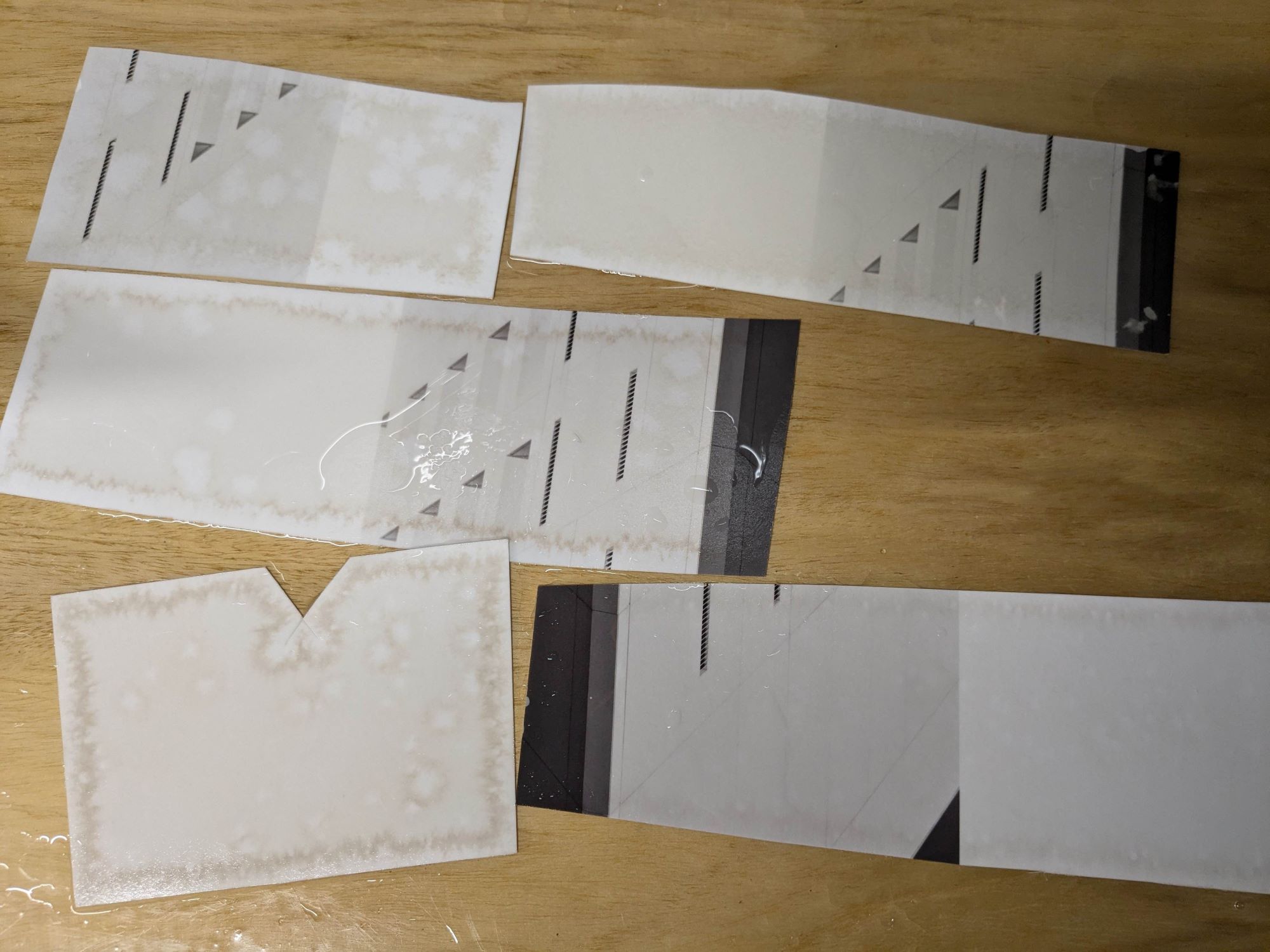

I'm getting splotchy stains on some of my prints after selenium toning and I'm trying to figure out where I am going wrong. The stain looks like what happens if you don't properly fix your print before selenium toning, but I think I'm doing everything right? Not sure why this suddenly became an issue.
I'm working with a relatively new bottle of Ilford Rapid Fixer and a new box of Ilford Multigrade Classic FB paper.
My process is as follows:
1. develop in 1L of Liquidol 1+9 for 2.5 minutes with constant agitation
2. agitate in a water bath for 20 seconds
3. fix in 1L of Ilford Rapid Fixer 1+4 for 60 seconds with constant agitation
4. rinse and store in a holding bath (up to several prints in the bath)
5. Selenium tone in Kodak selenium toner 1+9 until desired effect
6. rinse and move to wash bath
7. was for 60 minutes
After getting some staining on a recent print, I went ahead and made some more but this time using a fresh batch of fixer and fixing for 2 minutes. After making another 3 copies a processing as above mentioned (just with a 2 minute fix now) I got the following results:
First Print:
Looks fine.
Second Print:
Looks fine until the my scrutinizing inspection. You can just see some splotches if viewed from the right distance and lighting, or if you shine a bright light through the back of the print.
Third Print:
Visible brown splotches in the highlights.
This seems to be a pattern where later prints are getting stains. I had a similar problem a previous session (again with fresh fixer) after making a few prints. The fixer should be no where near exhaustion as I only made a handful of prints. I don't print enough to justify setting up a two bath fixer setup, so I tend to just make fresh fix for each working session.
Not sure where I am going wrong. I did order some more fixer just in case (and as I am running low).

Actually, sorry, I think I spoke too soon. I just took the prints out of the wash bath and moved them to different lighting. There are still stains, but much better this time. The pattern is similar. One print has no stain at all. Another has maybe the smallest hint of something if you squint and stared at it long enough. And a third that has more visible stain, but only really visible on the borders of the print. :/
Again this was with a new fixer bath. I don't really have room in my sink for a two bath unfortunately. I made my sink a little too small for that.
I'm going to try something. I'll take a unexposed, undeveloped strip of paper, fix it, wash it, and put it in the toner. Then see what happens. In theory nothing should happen, but if something does, then obviously something is off.

Well, I think I just discovered for myself that selenium toner only works on metallic silver, not silver halides. I did the following tests.
1. paper straight into the selenium = stains eventually (probably from light exposure printout)
2. fixed paper 1 min -> selenium = no stain
3. stop bath -> fixed paper 1 min -> selenium = no stain
4. developed paper with and without exposure in liquidol -> stop bath -> fixed 1 min -> selenium = STAIN
5. developed paper with and without exposure in liquidol -> stop bath -> fixed 2 min -> selenium = STAIN
6. developed paper with and without exposure in xtol -> stop bath -> fixed 1 min -> selenium = STAIN
7.developed paper with and without exposure in liquidol -> stop bath -> fixed 2 min -> selenium -> washed for 60 minutes = IN PROGRESS
I think I can conclude it isn't the developer in this case per Doremus' post. I'm not really sure what to make of this yet. If there is no stain after fixing undeveloped paper then I would think the silver halides are being adequately removed from the paper. But if I put the paper in developer first (as you normally would) then I get staining. Only variable I think is left is washing the print well prior to toning. I have a test strip washing right now and I'll throw it in the toner in about a hour. Fingers crossed it is just a simple issue of inadequate washing.
To be continued...

The results are in! The test strip I washed for 60 minutes prior to toning does not have any stain! Assuming this is a wash issue, I'm going to get myself a nice slotted print washer. Shuffling multiple print and keeping print submerged in a trickle tank is not a fun way to spend my time...
I would like to retest, but I don't have the energy to set up all my trays again today.
Also assuming this is a wash issue, I'm not sure I understand the interaction between the developed paper and remaining fixer in the selenium toner.
I'm trying to think through why this might not have been an issue before. Lately I've mostly been sepia selenium split toning my prints. This process requires a thorough wash prior to bleaching and redevelopment so all the fixer would be gone. Two years ago I was only selenium toning my prints, but I think I was using TF-4 which is an alkaline fixer. Maybe that is why I didn't experience this? Or a change in the paper I am using could also be the culprit?

I think I have a bad habit of prematurely celebrating? So now that the last test strip is dried I took another look at it. Viewing it normally I don't see any stain. But if I shine a bright light through it I still see stain....
So washing for an hour before toning certainly helped, but either wasn't enough or bad washing is compounding some other issue.
So things to try:
-2 bath fix regime
-different fixer (less acidic?)

I got my new bottle of Ilford rapid fixer and I did some more testing
Test 1 (control): developed a test strip, fixed in old fixer for 1 min, short rinse, selenium = stain
Test 2: developed a test strip, fixed in 2 bath fixer for 30 seconds each, short rinse, selenium = stain
Test 3. developed a test strip, fixed in new fixer only for 1 min, short rinse, selenium = stain
fixer dilution 1:4
Going to do some more testing with washing now

Completed some more tests. So far the issue seems wash dependent.
I made two new test strips. Both using the two fix bath process and toned in selenium 1:9 for 5 minutes.
This time instead of doing a quick rinse I washed one strip for 20 minutes and another for 5 minutes in water, 10 minutes in hypo clear solution, and 5 minutes again in water.
The strip that had the 20 minute water wash stained. But, it was barely visible in the white areas of the paper. The strip that went through the hypo clear shows no stain with perfect whites. I had a third party validate this too because I'm maybe going a bit mad at this point.
As previous commenters pointed out, I'm assuming this means the hypo wash is clearing out the residual silver compounds that is bonding with the selenium.
I ordered myself some Formulary TF-4 fixer like I used to use. I'm pretty sure I was using this stuff back when I was only selenium toning prints and I never had staining issues. I'm going to retest once I have it. I'm hoping that simply switching to a different fixer will help.
