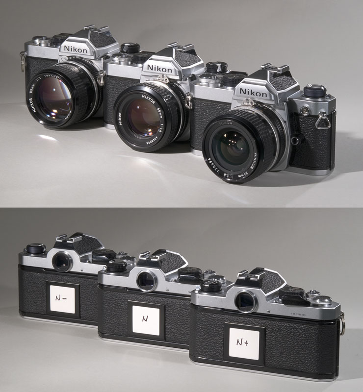

I agree, and it even works with multiple cameras for 35mm. In some cases, it costs less than interchangeable MF backs.

I have four Hasselblad backs:
Color C-41 160 and 400
Black & White 125 and 400​
so I have to check the back before I shoot so the exposure is set correctly.
Four 35mm one silver Nikon for 400 Color and a black Nikon for black& white.
