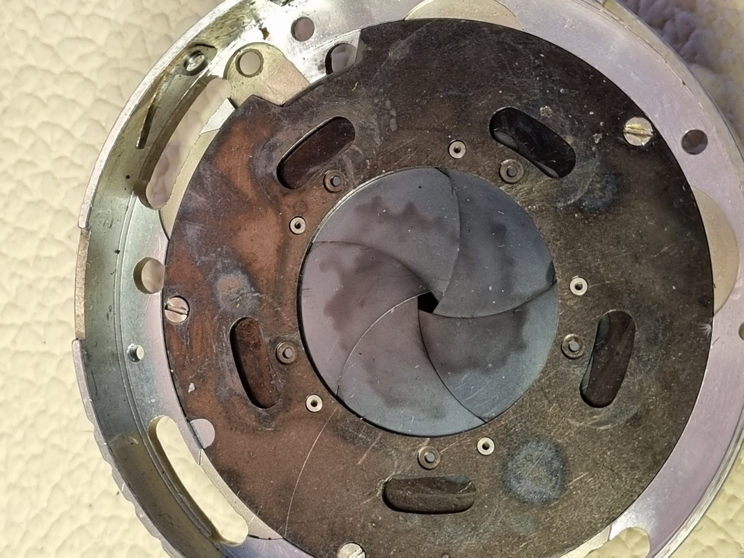

I'm fixing a Kowa SW that turns out to be a bit of a nightmare as issues pop up.
So I have taken everything apart and cleaned the shutter, aperture, etc... Now that I have put everything back I seem to have ok slow speeds 1.2s for 1s and 0.7 for 1/2s. But when I come to 1/30 I get 1/14, 1/60 is about 1/33, 1/125 is 1/52, so the camera will be more than +1EV.

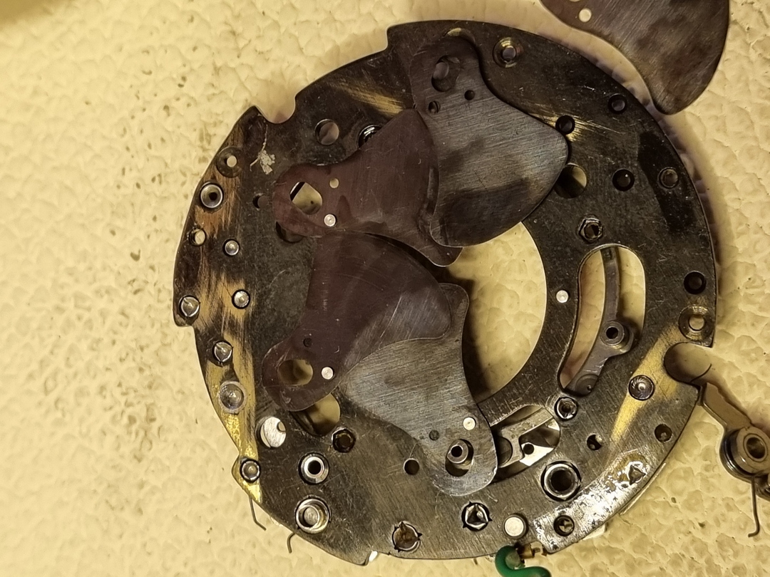

Here is what it looked like before I cleaned them: (I always forget photos after)
As can be seen somebody before me has removed some corrosion. The camera had corrosion marks several places. So what I am wondering is if it the the spring that is weak or that I need to take it all apart and sand down the plates above and below the shutter blades.
Any advice much appreciated.

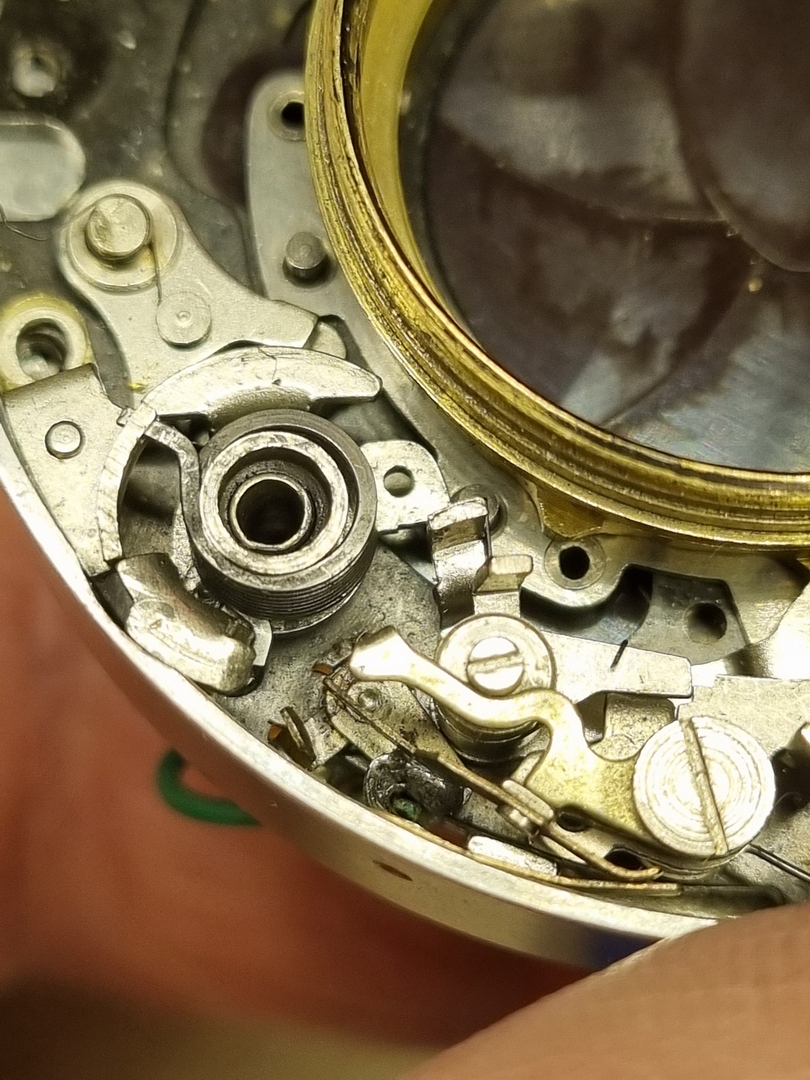

The spring:

I wouldn't recommend sandpaper for shutter and blade parts. Use metal polish. On the blades themselves, also. Then clean with a good solvent.
The main spring area looks dirty, but that could be the lighting or new grease I am seeing.

No not the blades. They feel ok and I do want to bend them. Only the plates. I've used 3000 and 5000 grit before on a Voigtländer Perkeo that was rusted, and it is still ok a year later. I'll get some metal polish and try that first.
All photos are from before the cleaning.

I think you already have your answer but, just to repeat, if you haven't cleaned the escapement you need to do so otherwise you're wasting your time. You also need a better way of checking the speeds (audio is pointless) and I'd advise reading up on shutter efficiency to understand its effects and why you will never get the speeds you're expecting.

If you do not have an ultrasonic cleaner ... take out the retard escapement and dunk it in a bath of IPA, swirl it about to clean out old crap. The retard mechanism controls the higher speeds.

Can you show a photo of the whole shutter assembly? If people can see the escapement installed we might tell you what to do where.
