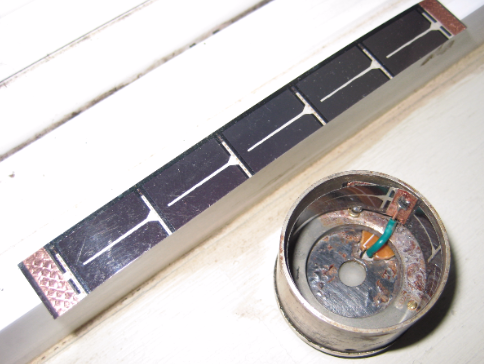

I recently picked up an SEI Photometer where the battery had never been replaced.
The corrosion was so bad, that after scraping out the old carbon and zinc I felt like a coal miner.
The selenium cell was, naturally, shot. So bad that chunks were falling off of it.
But I had played with the idea once of making a solar battery charger and had bought a few flexible solar panel pieces. I had one left that fit in a cylindrical shape (after cutting it in half). A little wiring and soldering...
Presto. A replacement selenium cell for the part that can't be found anywhere. Just cut a strip of solar cell material and place it inside as a cylinder and wire it up (Positive goes inside, Negative goes to ground).

Bill, how do you know the the solar cell is going to produce the same voltage as the selenium cell. It would be nice if it works out OK.
Bill Burk
Bill Burk
Feb 9, 2010
9,158
I don't know yet... I just shoved a flashlight in the barrel and the needle swung more than halfway.
The bulb mount was so badly corroded that I have some more work to do before I can mount a proper bulb (I have the right bulbs).
If anything I have more active cell area than the original design, and I assume the new cell materials are more efficient. So I'm pretty sure I will be covering up part of the cylinder with black paper because the needle will probably peg.
When it comes to final calibration, I'll just mark a new red line where the needle has to be to agree with another meter.

Feb 9, 2010
9,158
Well, I got the bulb/battery compartment assembled. The flexible cells must have lower voltage than the original cell, because the needle only travels halfway with the bulb at full brightness.

Thanks silveror0,
Good stuff.
Update. These flexible panels do the job! They are suitable replacements for the original cell.
I was fiddling around and broke a connection on the flexible panel. The place where copper joins selenium is very fragile on these things. You get one chance to solder a wire to it. Tin the lead you are trying to connect and then press it to the copper connector, solder for the briefest time possible... there is a plastic covering you have to melt and then the solder will spread. At the instance solder spreads remove the iron.
So I took the extra strip you see in the first picture and tried again, very carefully. Made my second one better than the first.
Checked with the voltmeter and got plenty of voltage. Put it back together and now I have full needle swing. The original standard brightness mark is "near" where I get correct readings.
