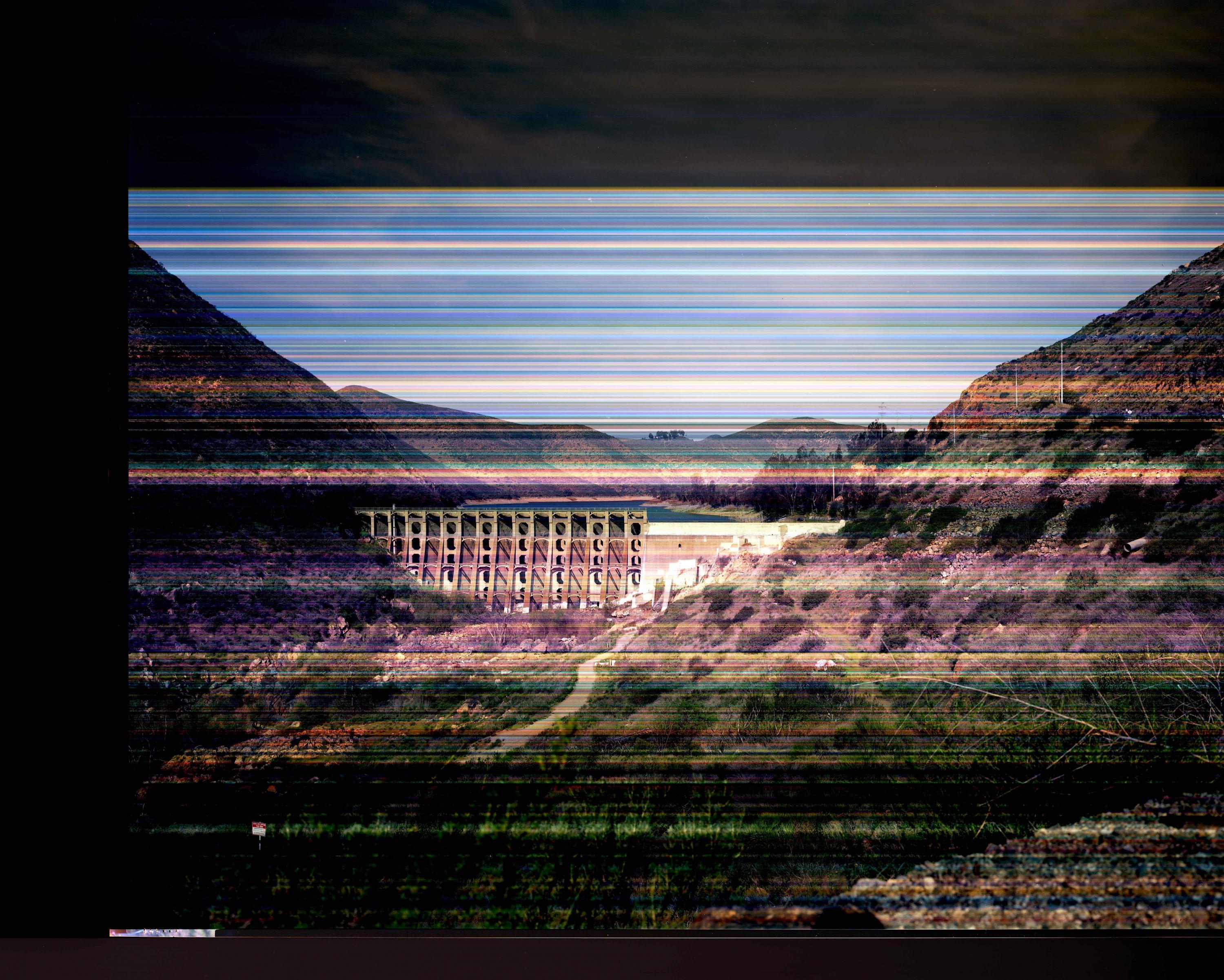

I attempted my first scan of an 8x10" negative using an Epson V700 flatbed scanner and it's essentially garbage. Epson/Silverfast software was configured to scan a transparency with no film holder; neither software produced a good scan. I suspect the scanner requires the negative to placed under an 8x10 film area guide as is displayed on this web page: EPSON V700 review

Yep that's pretty bad. Make sure you look at an on-line example of the 8" x 10" film area guide if it is available. The important feature of the 8x10 mask that came with my V750 is that there is a gap at the top of the mask before the scanner reaches the negative. For some reason the scanner needs to see blank white light before it starts scanning film. Don't put your negative to the top right corner of the scanner glass or you'll get these lines throughout your image.

it looks like a dirty light path to me. I'd clean everything from the light source through to the sensor.

I relocated the negative to leave a gap of about 1/2" between it and the back edge of the glass; and then retried. The scanned output now looks as expected.

if the 700 is like my 1680 there is a narrow peice of glass at the top with a seperator between that and the main platen. the upper narrow window is the calibration area and must be clean and clear.
that's how I see it too ... on a quick look that is

you didn't put the image on the glass right up against the edge of the scan area did you?
