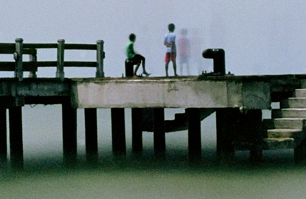

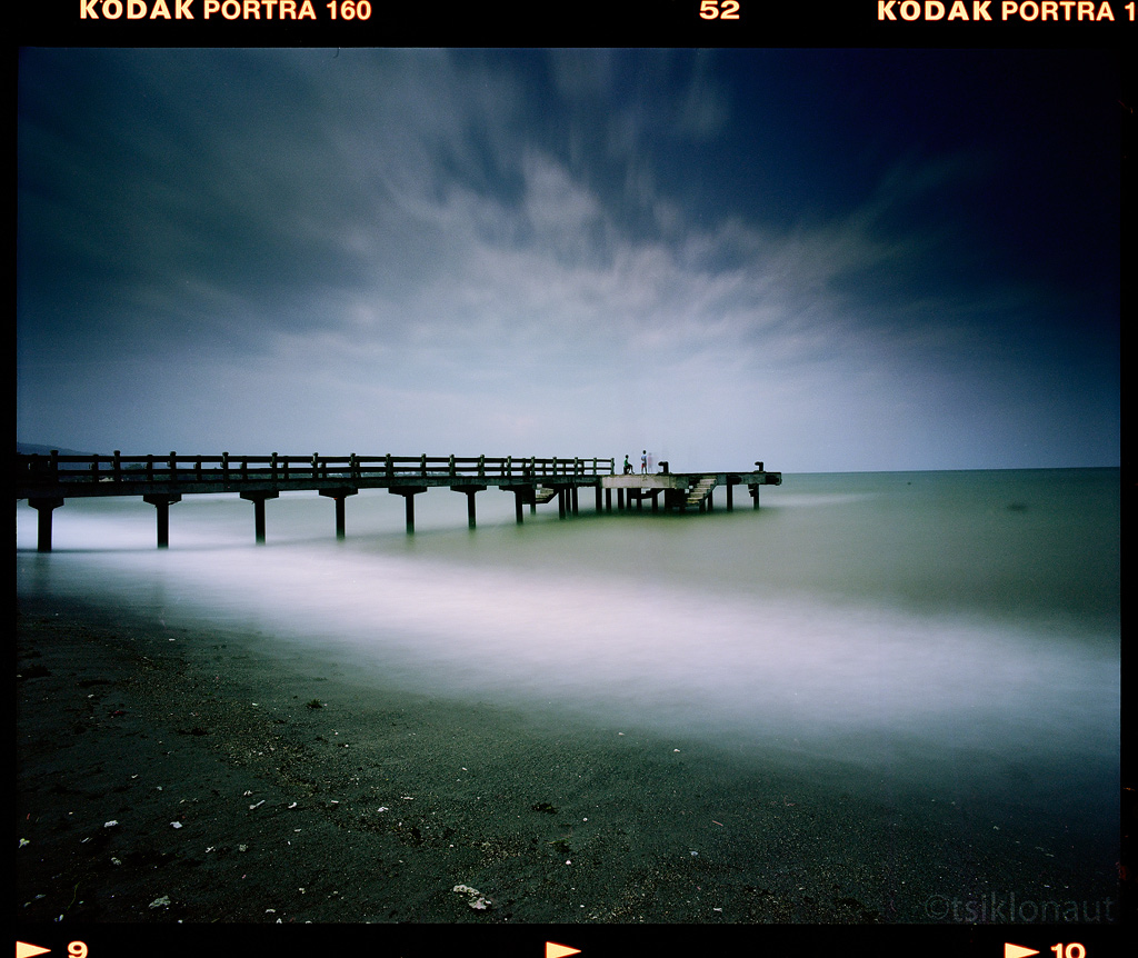

In C41 the new Kodak Portra 160 does fairly good in long exposures. 2 minute shot from a 14-bit drumscanner:
100% unsharpened crop (this you can sharpen up in PP):
Wrote some thoughts about it here.
