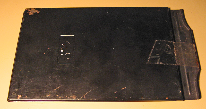

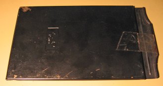

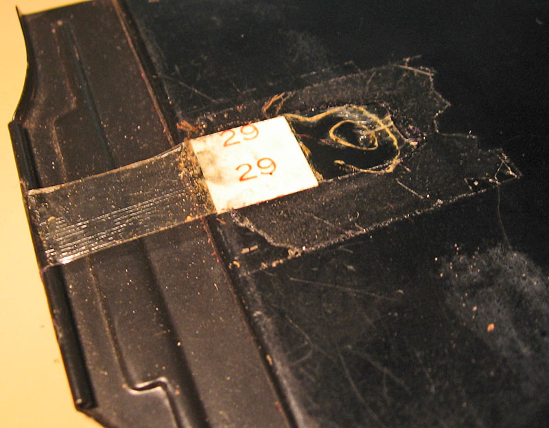

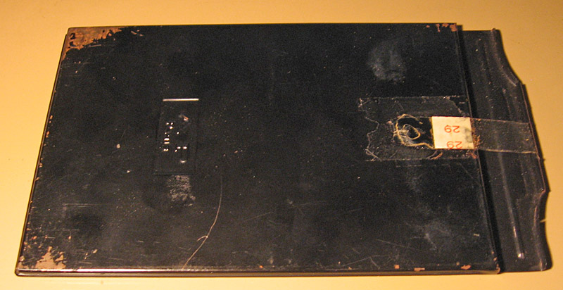

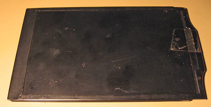

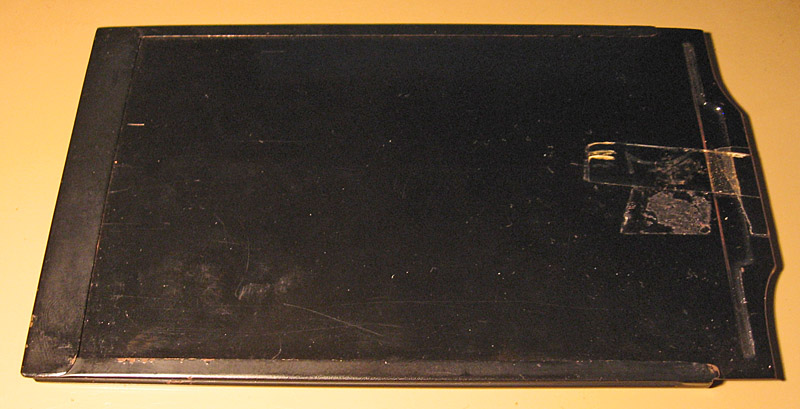

Some photos below of the two taped plate holders. One has been taped up with broad tape, and the other with narrow tape. There is also a remnant of broad tape on the latter, as well as a number, 29, printed (not hand-written) on a small piece of paper stuck under the tape. The camera and 3 holders came in a leather box-type case which is just big enough for these - certainly not big enough to hold 29 or more plates.
The number also repeats, as if it came from a roll of paper with the number on it all the way through. Could this have been applied by whoever supplied the holder loaded with a fresh plate? Would camera owners have bought rolls of paper with printed numbers to do their own indexing of holders? Wouldn't they have just hand-written the number on a label, or painted it on somewhere?
Holder 1, dark slide side.
And the other side.
Holder 2, dark slide side.
And the other side.
Close-up of the number.
