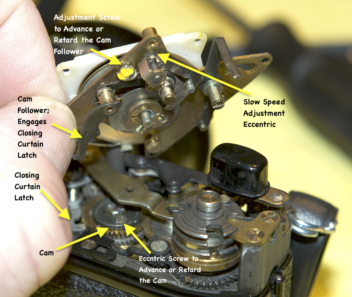

I'm working with a stubborn camera in which the 1/1000 speeds are crazy fast and all over the place.
The camera has cloth horizontal focal plane shutter. A spinning cam on the first curtain gear disengages the second curtain, via the closing curtain latch, as the cam spins. It does this by pressing the cam follower into a pin on the closing curtain latch.
I'm trying to track down the cause of the problem.
We know that the faster the first curtain travels, the quicker the second curtain will release. So, I wanted to see if the crazy results were from randomness in the opening curtain speed.
So, I plotted the second curtain delay after first curtain release (should be 1000 microseconds) against the speed of the first curtain.
Correlation (R^2) was close to Zero, so, randomness in first curtain speed is not causing this. In fact the curtain speeds are pretty stable, clustered over an appropriate narrow range.

The camera has been disassembled cleaned and lubed. The curtains do have pretty consistent speeds.
Things I was thinking:
1) Yes, something loose
2) The second curtain latch, as is common, does not engage the second curtain spinning gear until the shutter button is depressed. Is there some interaction here? Does pressing the shutter button a certain way cause the latch to engage better or different (so it releases different). I checked and it seems the latch is always all the way over fully engaged by the time the first curtain is released.
3) The axle of the second curtain latch not free moving? I re-lubed this area with no change.
4) This is the best it is going to get with the camera design and aged components (give up on 1/1000, use 1 sec through 1/500.)

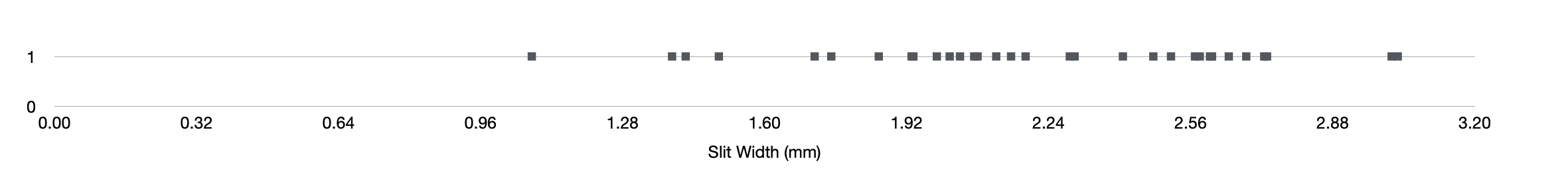

Here is another graphic representation of the data. This shows the slit widths at 1/1000. Again, all over the place.
