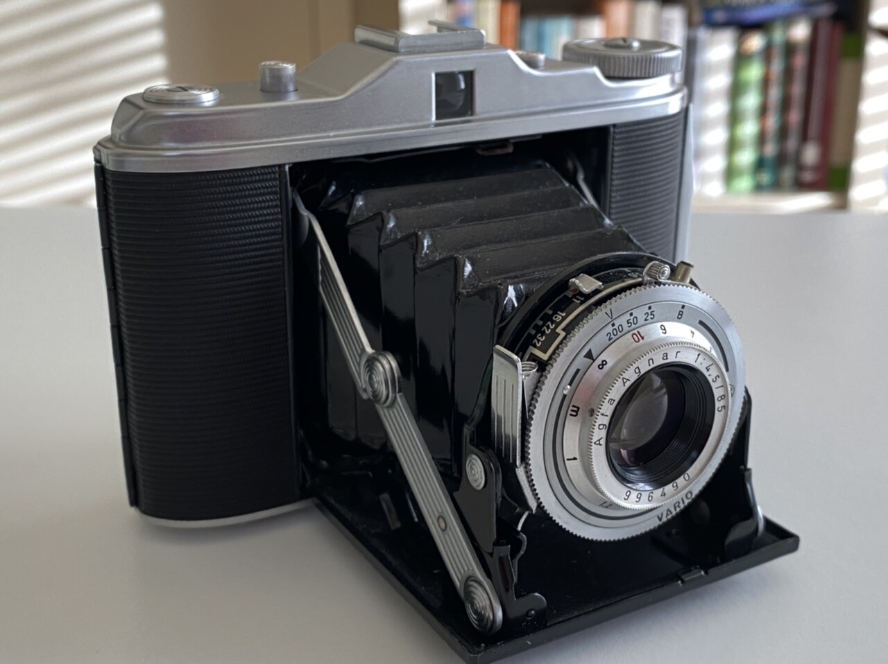

Just for giggles I used an Agfa Isolette loaded with Pan F during a walk today.
The focus on it is stuck so I'm going to have to remove the lens to get the old lubricant out.
But hey, it's fun and more portable than a Fuji GX680.

What are the qualities that disqualify the Mudan? I also have an Agfa Isolette. I like the MF folder species of camera. I’m not sure I’d call it rugged however. Are any of them rugged?
