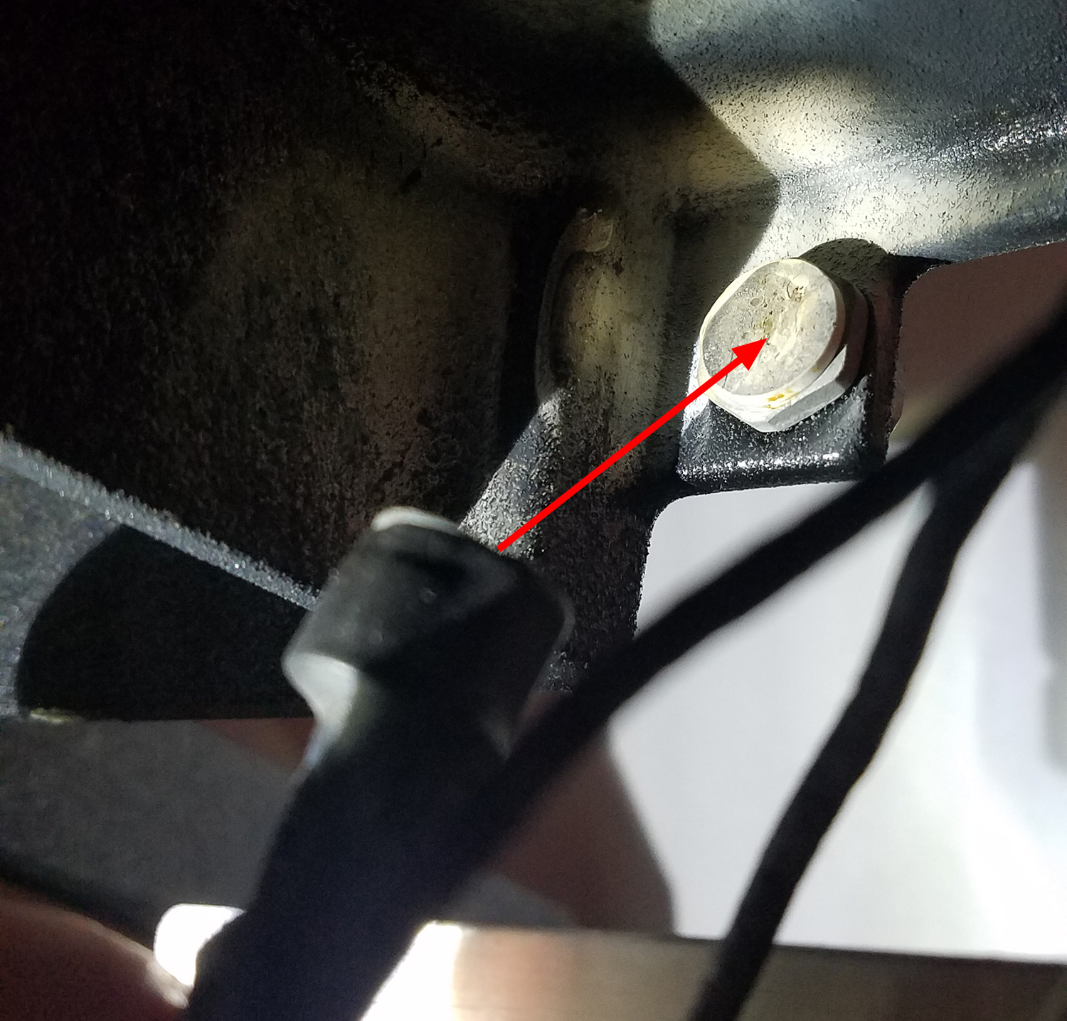

I know this thread is 11 years old now, but I have a Seal 210 (circa 1974) that started overheating, then one day started to smoke. I thought I would try it again with an old VariAC I had kicking around, but now all that functions is the power light...

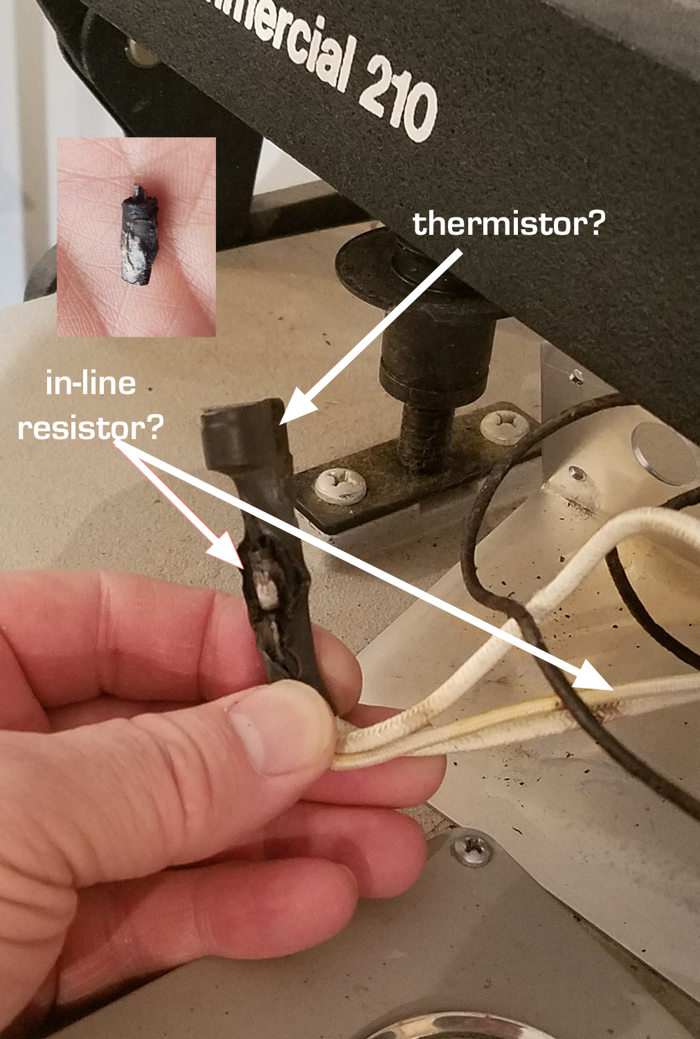

After taking it apart, I discovered this melted sheath of wires. It looks like there's some sort of resister in it, plus it looks like the top was at one point, glued/welded to a stud that's bolted to the frame.
I only knew about a switch and a thermostat and sensor. What is it that melted? Can I bypass it somehow maybe with this? 2019-11-14-20.45.33.jpg 20191114_203041.jpg

Yep, it's more or less the same principal.
However, if you cut open that shrink wrapped bundle of wires, you should find a thermistor in a standard electronics "can" package with spade lug terminals. There should be nomenclature on the part to order an exact replacement from Mouser or Digikey, which might be even cheaper than that kit. All you would have to do is swap it out for the new one; making sure to keep the wiring the same and epoxy the new thermistor onto the aluminum stud with high temp epoxy.
Keeping the defective thermistor in the circuit might prove to be a fire hazard, as it is probably burnt and is almost certainly defective.

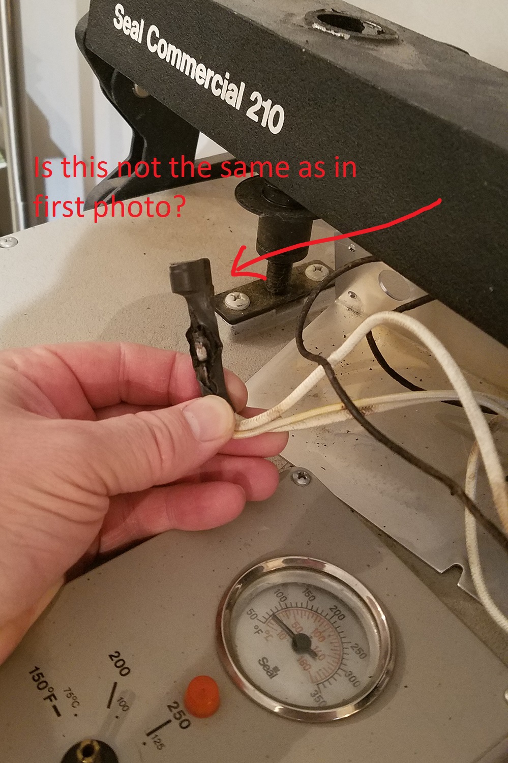

Are you referring to the large 'dial' on the end of the bundle of wires as the thermistor? The heat tape is so stuck to it that I'm not sure I can get it off. There's also a smallish "can" type of package that you can see in the photo of me holding the bundle. It joins two wires together. But when I went to peel the heat tape off, the thing just flaked right apart in my fingers!

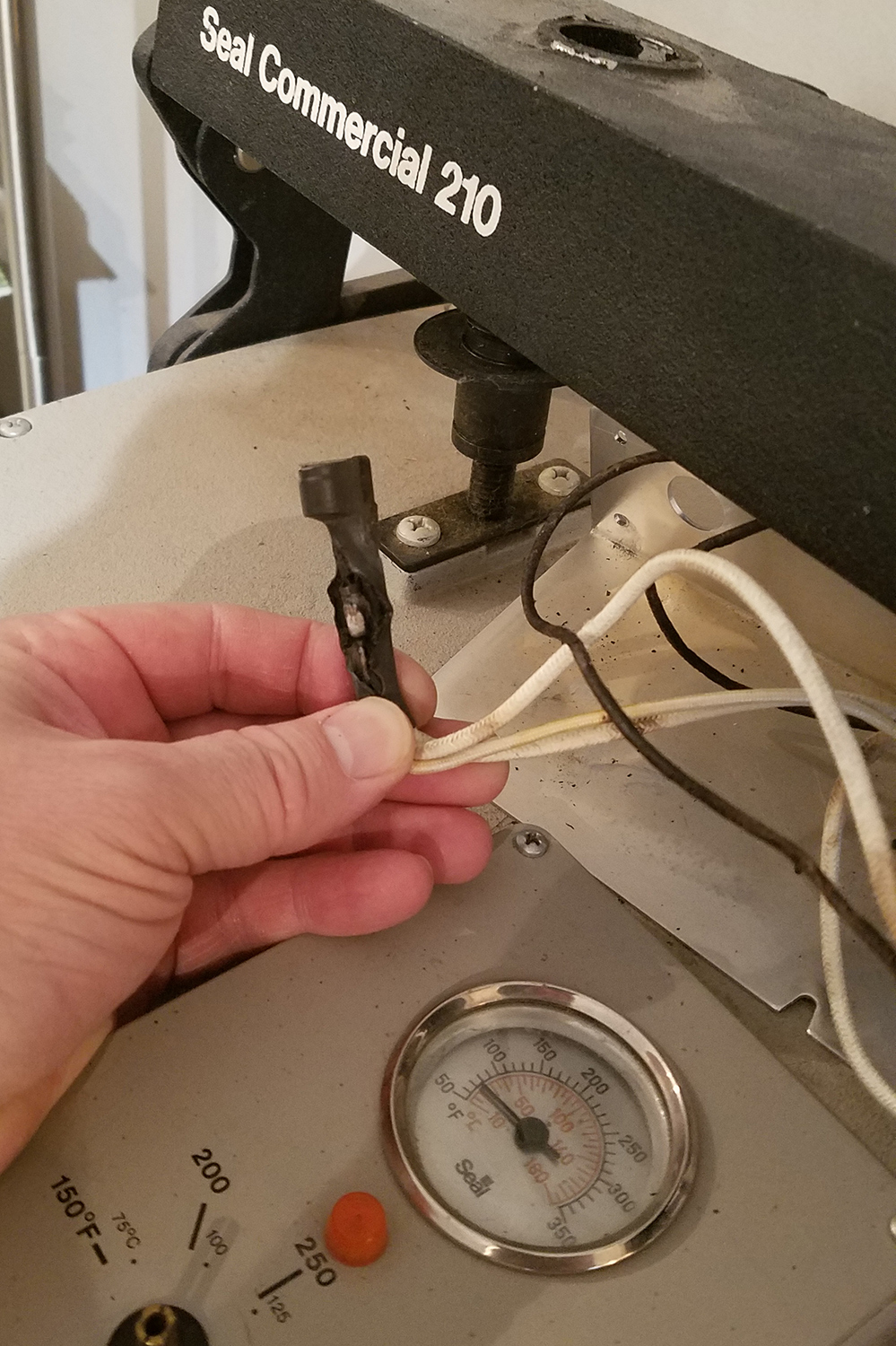

Dial?
I thought the two photos were of the same item. The thermistor should be at the end of the wires. I don't see any dial.

I will do that. By "dial", I was trying to describe the shape of the object at the end of the wires. To me, it looks like there's an in-line resistor that is wired to the third, thinner white wire. I've attached an updated photo with stuff labeled, plus what's left of it.
As I think about it, I'll bet the epoxy came loose first, causing the press to over-heat the last few times I used it, and eventually the smokey melt-down when I left it on too long. So is the "thermistor" the same as a temperature sensor? Or is that all done by the thermostat dial in the front of the unit?

I theorize that the resistor failed, allowing the thermistor to run full-power until the heat melted the epoxy and it separated from the heat sink.
It could be that the thermistor is still good, but will run full-power without a working resistor. Of course, something else could be defective up-stream, which would explain why the resistor is a charred mess.

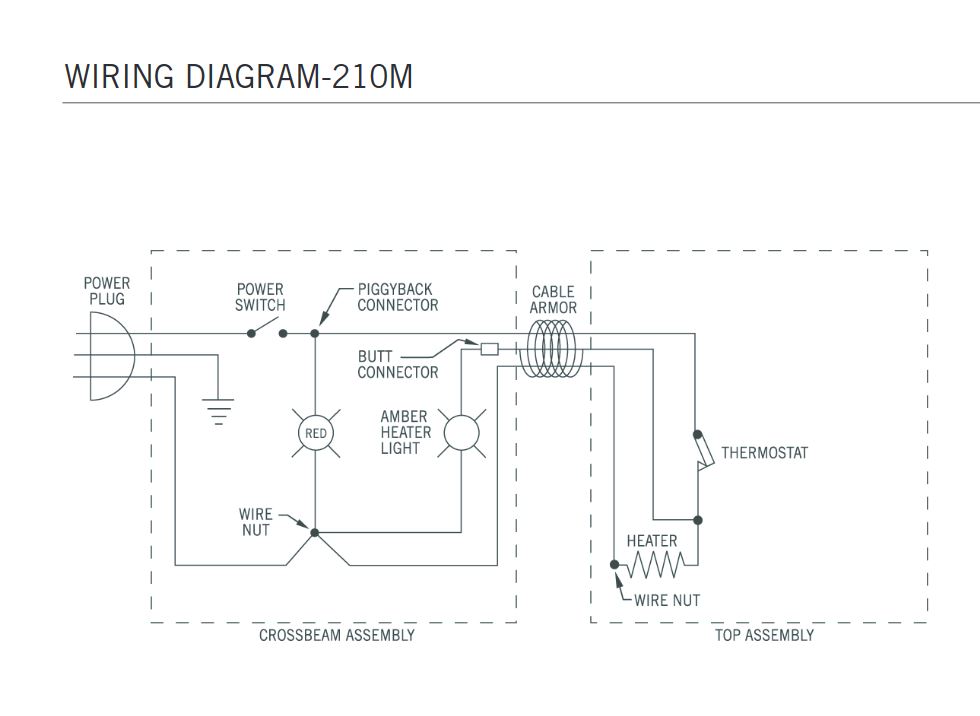

In the end, it MIGHT be cheaper to implement your original idea of the outboard regulator IF you can find a safe way to hard-wire the heating element to bypass the thermistor and be regulated by the Elitech STC-1000 Temperature Controller.
It looks like the YouTube user who did the modification hasn't responded in years to questions and unfortunately, the two users above haven't been on Photrio/APUG for at least a year; one or both of them have the wiring diagram...

FWIW that schematic suggests to me it's not a "thermistor" but a mechanical thermostat. There are devices that have a slightly domed bimetallic disk in them that pops one way or the other at a preset temperature. We had a clothes dryer which was running hot and it turned out the normal dryer heat sensor had stuck permanently on, but a second thermostat that functioned as an overheat limit was setting the temperature. Normally they are mounted by some sort of stud or clamped down by a metal bracket. I'm thinking the fried unit upthread may have been stud-mounted and arced to the point it disintegrated itself. Anyway, if you can find a source for one of the desired temperature, it might be pretty inexpensive.
