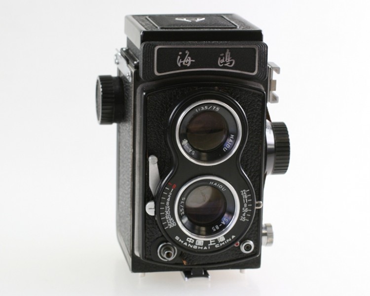

I have a seagul tlr the 4a-109 I think is the model number. It has the better teaser type lens and is basically a very close copy of a number of other tlrs like the Rollie's or yashicas. I like it, simple things like auto cocking with advance, and auto film counter reset and a hotshoe make it easy to use. But there are quality control issues, the split prism that it has is misaligned it's not quite horizontal and not quite at 45* just crooked lol. The images are good from it but not as sharp as my older yashicaflex.
AaTen
Jan 20, 2013
9
Med. Format RF
Yeah there was a tessar type of Seagull 4a, I never tested one,
they are quite rare...
but I like the standard HAIOU 85 lens (Anastigmat 3 elements but very high quality with Zeiss Glass imported from former GDR, its sharper than a Agfa Apotar of my Agfa folder), Haiou SA85 has a very nice bokeh and its sharp.
http://farm4.staticflickr.com/3295/2647420922_159c799962_z.jpg?zz=1
These are the older 4b from the 70s with handknob advance, they are reliable and the SA85 is a good simple lens....astonishingly good, I have seen less sharp Tessars in other cameras compared to this nice Anastigmat.
http://www.foto-sandor.de/images/produkte/i18/18576-IMG-0515.JPG
Do you know wether the later Tessar 4B also had imported Zeiss lenses?
When was your camera built?
I never saw one.
Could you please tell us code of the lens HAIOU and than the number of the tessar type?
Is it even called "Tessar" if yes its defintly a Zeiss split off....maybe older
Rollei lenses that Zeiss still had on stock during the 80s and later sold to the chinese factory?
