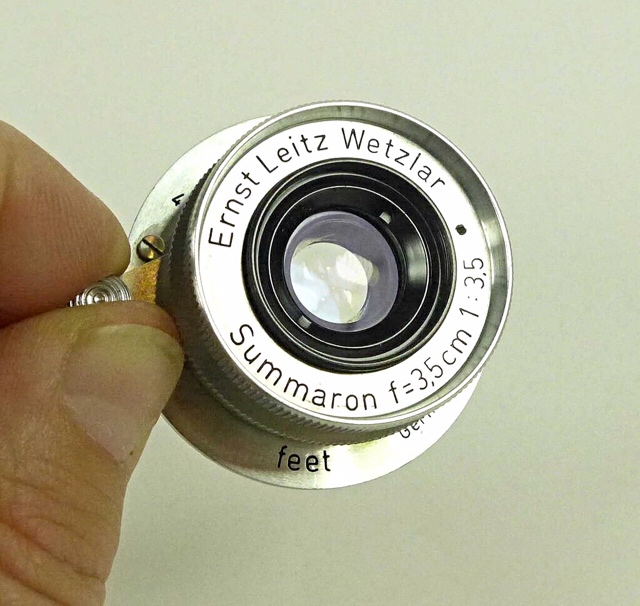

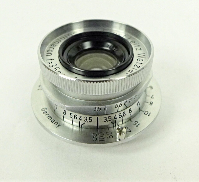

I purchased a 35mm Summaron f/3.5
Should be here this week. I'm pumped.
ImageUploadedByTapatalk1430872207.568026.jpgImageUploadedByTapatalk1430872292.738378.jpg

I have never had an opportunity to use a Summaron. Enjoy it.
In 35mm I finally settled down (that is a term gear addicts use to mollify their significant others) with a very nice Nikkor 35/2.5 and a Voigtlander Color Skopar 35/2.5. The Nikkor is almost a continuous resident on my Leica Standard.

I was looking at those Voightlanders. Beautiful lenses.
I got the lens from Dan Tamarkin.
View attachment 108585View attachment 108586
Very nice lens. No modern Cosina or old Japanese are near to it in terms of the build quality. It has interesting and special rendering on bw, I call it as grainy contrast.
