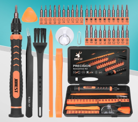

I use this for pretty much everything that involves small screws and whatnot:
You can find it and similar kits by searching for "JOREST precision screwdriver set". There will be plenty of Amazon and eBay links. Price is around $10 if you shop around a bit.
These are not magnetic though.

Thanks for that I’ll check them out, to hold the screw to the driver I often use a tiny bit of super glue as my hand is not the steadiest.

Actually I am looking for a set with magnetic tips, came across this on Amazon identifies as magnetic tip , wondering is it the same set as yours ? please advise.

Actually I am looking for a set like this too, according to the site, the set has magnetic tip, is this what you have ? Please advise.

I was looking at this same set and noticed that according to the site , it mentions "magnetic tip". When you ordered your set , did it mention the tips are magnetic ? I just want to make sure before I order one. Thanks.
I think the 'magnetic tip' refers to the bits sticking into the holder, after which you can screw the holder tight so it grips the bit. The bits are not magnetic in the sense that screws will stick to them. IDK if they can be magnetized; I've not tried this. I honestly don't know what the ad said when I bought this kit; it was a €10 purchase. I didn't pay much attention; it looked nice and it turned out to work quite well, too.
