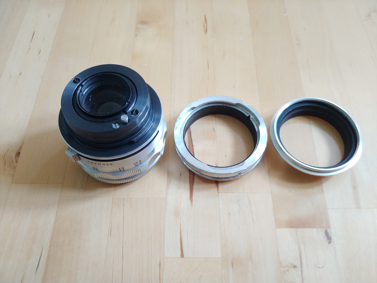

since my problem with a stuck macro extension ring sounds similar (I should have posted it in "repair" instead of 35mm probably), any tips for me? Here my thread: https://www.photrio.com/forum/threa...-extension-how-to-remove.200405/#post-2702505
I think on getting a lid removal/strap wrench as the next step. Maybe two, one for the lens and one for the ring?
It seems like it wiggles now a 1/3 mm back and forth, but is still stuck. Rubber bands alone wasn't working
I have found these filter wrenches to be very good for both filters and for lens group removal. They are made with a heavy spring metal rod shapped as shown and then coated with a thick grip material. The coating is a bit like the latex on work gloves. You'll need to find the right size, of course. Much much better and stronger than the plastic filter wrenches.
[edit- not sure waht is going on but the link is not showing for me. Go to Amazon and search for '
Neewer® Rubber-Coated Metal Camera Lens Filter Remover Wrench '​
Do you think these filter wrenches are strong enough for my macro ring (see post just above)? The neewer is at least metal, not like some others from plastic. Since the grip area I have is narrow, it might actually be better then a strap wrench. I guess I'll have to try it out...
I can't promise, of course. The wrenches are fairly strong and allow for a tight squeeze. Unlike the plastic ones that will 'fold' if too much pressure is applied.
I've found that the red rubber sheet gasket material sold at hardware stores as the first layer inside a filter wrench or strap wrench can also be a big help. Especially if the part has projections or bumps like a bayonet filter.
And then double sided tape can give a good added grab. Sometimes it allows for less pressure from the wrench itself so there is less chance of distortion. Sometimes it's after pressure is let up and you lightly turn that the item can unscrew.
I got that macro ring off! I had stuck it in the freezer over night, just to try that out. When I took it out and it was still cold, still no success with two rubber bands. So, now just before ordering the filter wrench, another try with rubber bands, and it just sled off. No idea if the cold and warm up help, or the rubber bands were any different, or me holding it down (not really strong) on a mouse pad, it was in the end not tight anymore.
