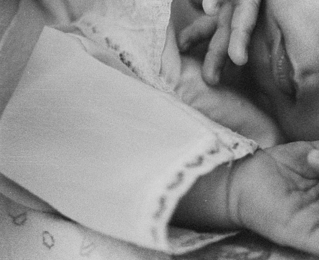

Hi there,
anyone who could give me a useful advise here, appreciated.
I am developing my own B&W film, one roll at a time. Everything is under full control. As soon as the film is dried I cut it in 6 (35mm film) and insert them into the plastic sleeves (Print File Archival Storage Page for Negatives, 35mm, 6-Strips of 6-Frames). The next day I pull then out and scan on Nikon Coolscan.
I see a lot of tiny hair scratches, not the thick long scratches what you'd get improper handling, but really tiny once.
I attached an example.
Any suggestion how to avoid these?
thanks for any help.
Miklos

The scratches in the sample you attached are white. With scratches first we need to know whether they are white or black.. White = back of film, Black = emulsion side. You are lucky. The black ones are much harder to fix, except in photoshop. They are scratches that remove the image.

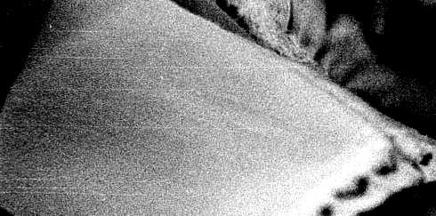

I've copied a portion of the image you supplied and increased the contrast substantially so the scratches are easier to see; attached. Now that I see them better, I have to say that it seems extremely unlikely that they are from the negative sleeves. It is far more likely that they result from microscopic particles on your pressure plate in the camera. They are very straight, parallel lines. If caused by the sleeves, they would not have such a regular appearance; they would be more random.
If this is true, hardener won't help, because the scratches will be there prior to processing. Hardener can help if the scratches occur after the film is processed.
Your pressure plate may appear to be clean, but I suspect that it is not. These problems can often be extremely hard to isolate.
