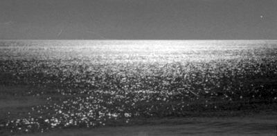

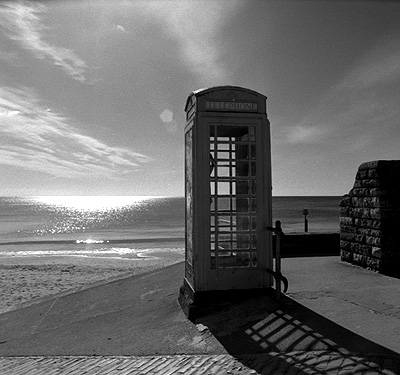

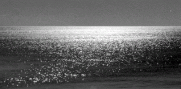

The worst thing will be a tiny, tiny bit of flare. You can remove that (almost certainly invisible) problem by using some India ink or similar black permanent ink to fill the scratch.
I have a crater the size of the Mare Tranquillitatis filled with India ink on one of my SQ-A lenses and can happily shoot directly in to the sun with only normal flare...
Cheers, Bob.
Below is a simple neg scan with no manipulation from the damaged 50mm PS lens with the sun hitting the lens (and the red Cokin filter which is probably responsible for most of the flare...) and a detail of the sun reflecting off the water.
