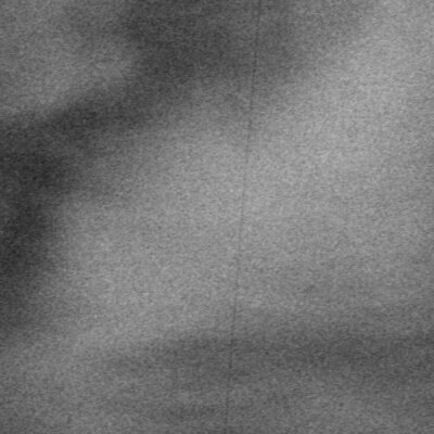

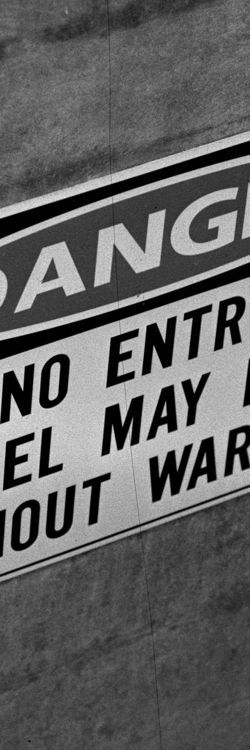

This is what it looks like, at about 2000dpi:
The scratch wanders around the middle half of the frame parallel to the roll and sometimes there are two or more parallel scratches. Their wandering makes me think that it's not a fault with the film back (it was shot in an RZ67, with a back that I've only just bought off APUG).
There are also a bunch of scratches at the film edges, about 6mm in. Nowhere near as continuous as these big long ones but definitely annoying - they're all quite visible when looking at a whole frame.
So, is this something I've done in processing (I really doubt that as I've never seen such a scratch before and did not squeegee this roll... but something else maybe?), is it a mechanical problem with my new back, or is it a manufacturing issue? To say I'm grumpy about it would be an understatement and I'm not real keen to shoot the remaining rolls just yet unless I know the cause.

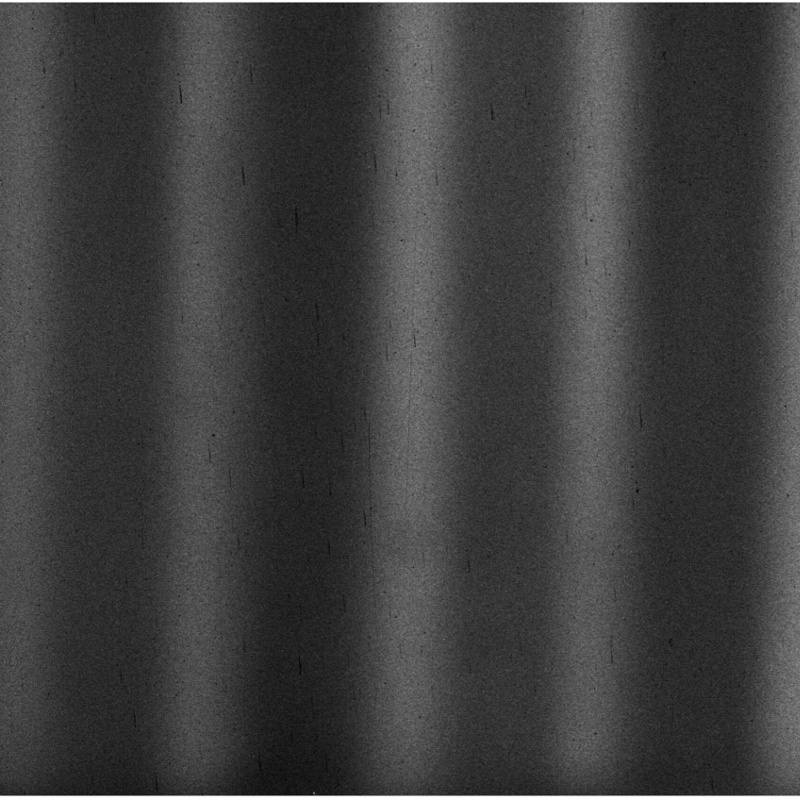

Edit2: there are also these small scratches in both rolls (about 2000dpi again; image here is out-of-focus corrugated iron):

The small scratches that you see are identical to what I have seen in Fomapan 100-120. I started (there was a url link here which no longer exists) >1 year ago.
The problem is the film, not anything you can help. Foma have said (through their distributors) that they would try solve the problem by mid-2010. It seems they have not been successful.

So it's about 2 months later now and I've shot about 30 other rolls (of other films) with zero scratches since this Fomapan issue. This week I put the Fomapan back in again... and it's scratched. Yes, the big ugly gouges. I'm pretty sure the film came out of the factory damaged like that and am highly unimpressed.
