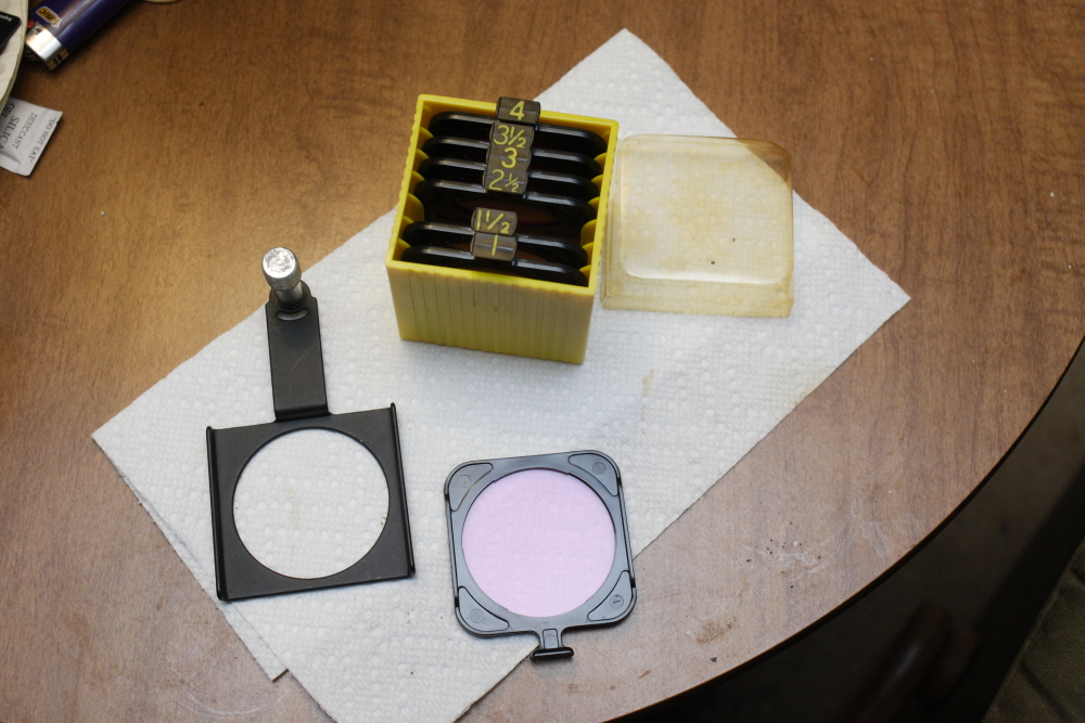

You could explore using under the lens contrast filters like these by kodak
The black metal thing to the left is the bracket that omega made to accommodate these type filters in the olden days.
It attaches near the lens board on the enlarger and allows you to swing the filter in and out of the image path.
I used these filters for a year or two until I got a newer head that had a filter drawer.
Now I have replaced that head for a Dichroic version so I can do RA4.
The under the lens filters work very well - especially if you aren't switching lenses all the time.

I've used VC filter all the time, and find them not to be a problem. The under lens setup the Bruce shows is even easier to use than dealing with a filter drawer.
