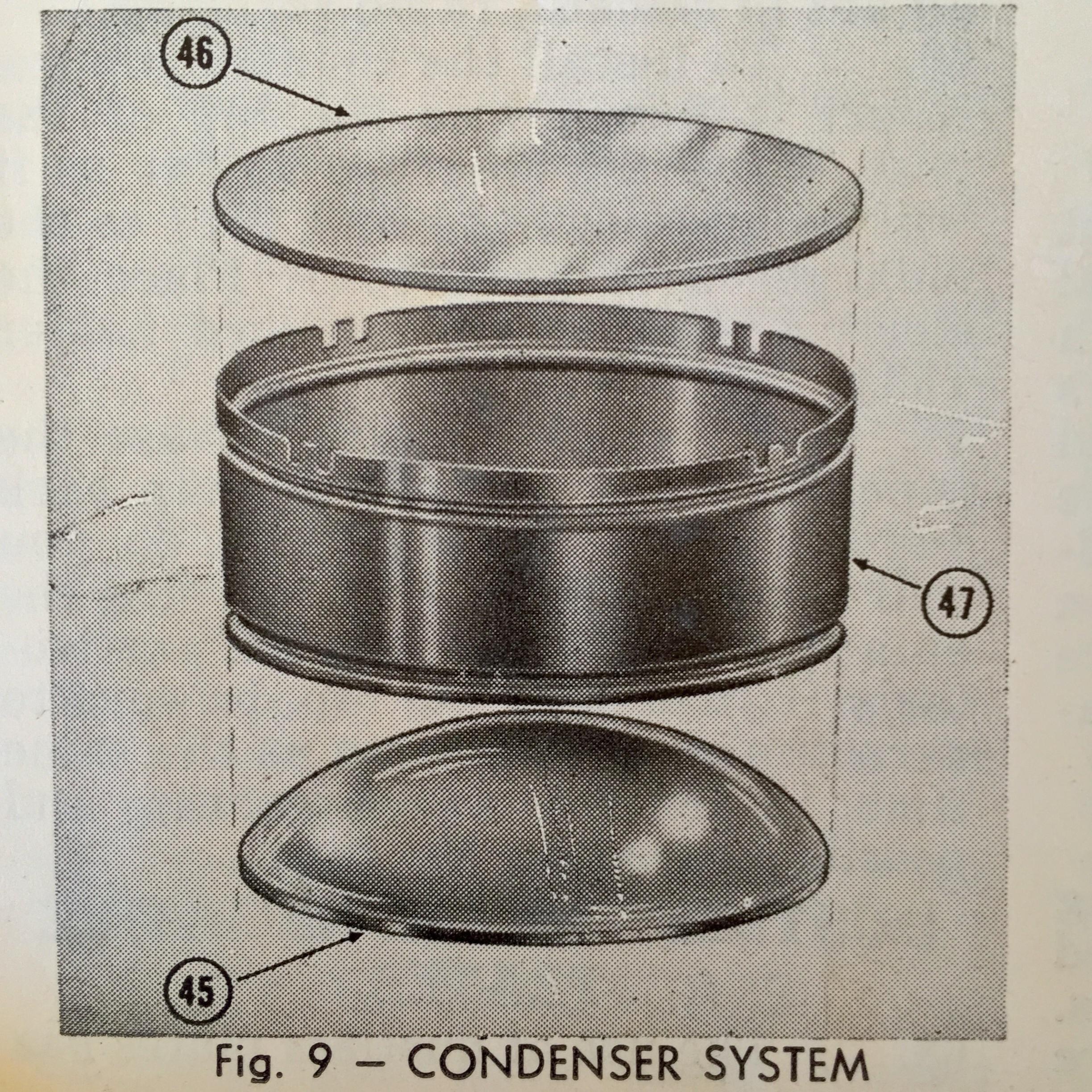

Mike, I think this Federal 279 is as well. It looks to have the optional condenser accessory. In the manual it says to change the clear bulb with an opal bulb when using the condenser add on.

You are right, just remembered that a opal (white) bulb is necessary for for my omega D2 condenser enlarger, a clear bulb would project an image of the bulb filament other wise. There are point light source enlargers but I do not know much about them.

Here is a picture from the manual showing the condenser in the 279.
