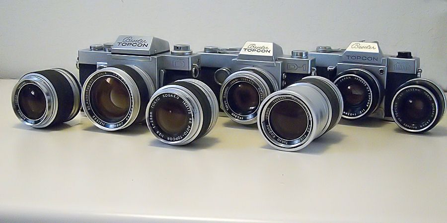

I now have four Super D bodies, all shutters work at all speeds (I tested with B&W film across the range of speeds, and have consistent film density), two of them have functioning and accurate meters. In also obtaining a functioning D-1 body in addition to the Auto 100 that i have had for 50 years, I can post a photo of my Beseler family of cameras, similar to the magazine ads of the late 1960's
