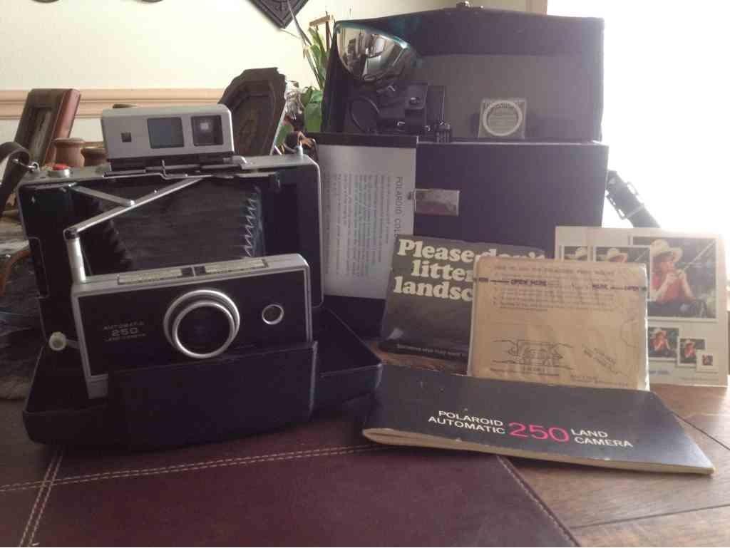

Look what I scored at the flea market today!! Complete with cold clip, case, manual, flash, unopened print mounts, polarizer filter, and an non-corroded battery that still has juice in it!! And it was only $20. I nearly passed out when I saw it.

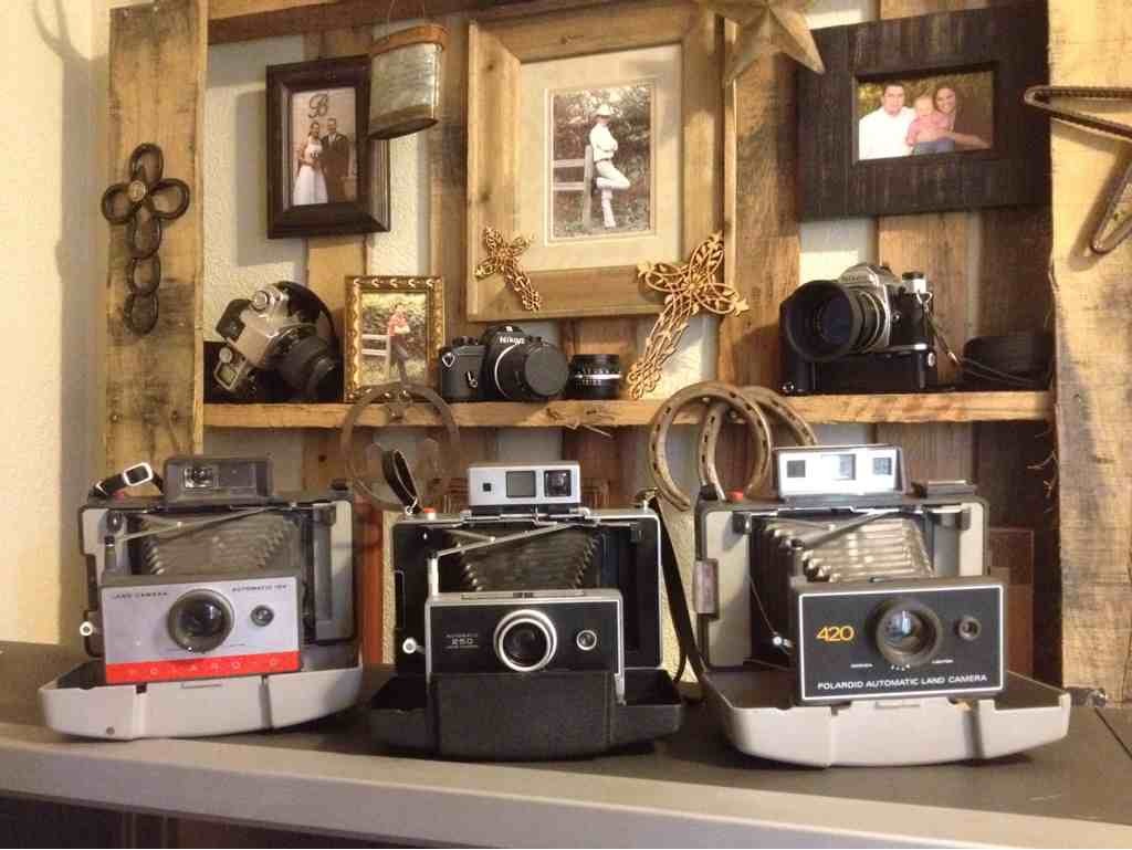

That makes three now! The 104, the 420, and now the 250! I lurve them all!! I shall call them the amigos!
