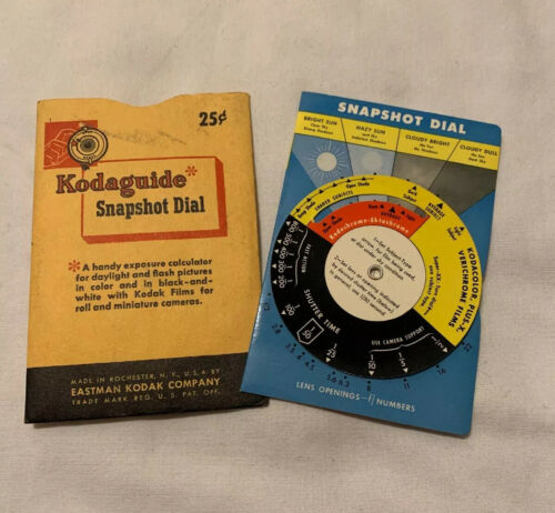

Kodak took a bunch of pictures at Willow Pond in Rochester and made a bunch of prints and asked volunteers which ones look best. Then Kodak reverse-engineered the pictures they liked and related meter setting to the film ability so amateurs could make the best pictures. That was ASA. Later when cameras got better light meters they took out about a stop of safety factor they originally built in. That stuck and became ISO. (All true but storytelling mode).
Very interesting backstory. Let's say I'm shooting Delta 400 in my SRT-101 and I have the camera set to box speed. What would be achieved by changing the camera setting to a lower or higher ISO than 400?
