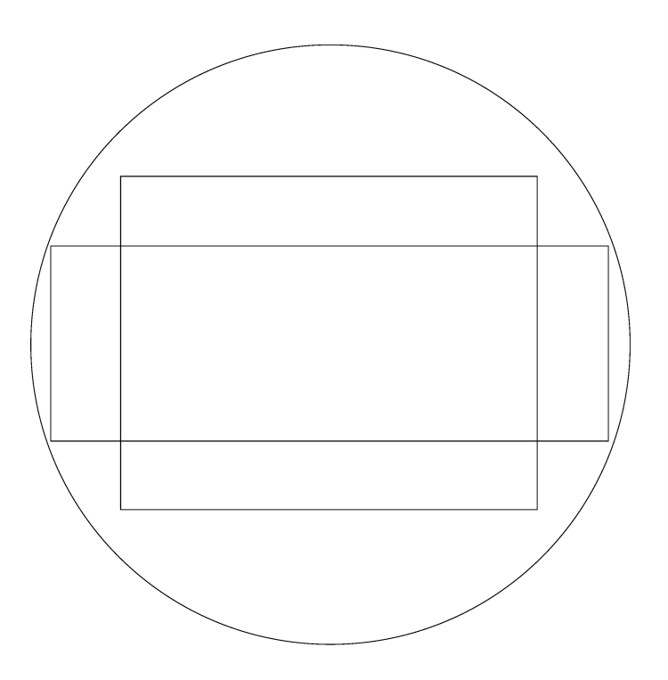

Here s why. Think of full frame sensor in the drawing as large format and cropped sensor as 35mm. Forget the green lines and just look at the red and blue and the one front lens in the diagram. The larger sensor or film format sees a larger angle of view of light rays from the same lens.
https://goo.gl/images/Kg6bWY

Angle of view should be distinguished from angle of coverage, which is related to image circle and potential view camera lens movements, which varies not only with lens design and focal length, but also lens aperture and acceptable degree of enlargement. That's the whole point of view cameras, and not just point-blank shooting. I often use some of the same lenses on 6x9 roll film backs as with 4x5 and 8x10 sheet film. A lens which a relatively wide angle of view on 8x10 film will behave like a long focal length (telephoto-like) on much smaller roll film formats.
