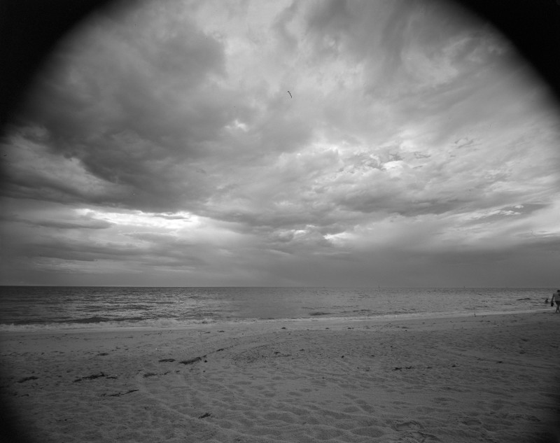

Don't put on a 49mm filter, or even 49-52mm step ring and 52mm, I think that's what I did in the first sample.

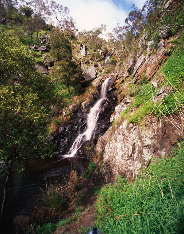

This next one was with the centre-filter, no vignetting. The smearing in the top left isn't softness, I think it's a bit of tilt and swing (the other three corners are sharp).
Also, it's wide. Wide. Don't get the front of your monorail in the shot. As for contrast, this is RVP50, colour-calibrated scanner & screen, no digital enhancement (the chrome looks the same as my screen).

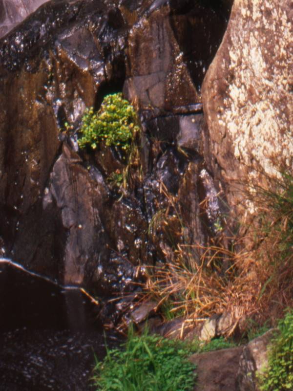

Not the sharpest LF lens I've got (that would be my 90mm Fujinon SWD), but this crop of the above shows it's definitely usable at 'sane' levels of enlargements (you could easily get a 16x20 from a 4x5 without seeing any softness). This was a 3200dpi scan, cropped to 1200x1600 and shrunk to 600x800. There may also be some diffraction softness in here, I stopped down a bit to blur the waterfall and it may have been at f/45, it'd be sharper at f/16-f/22 where I normally use it.
