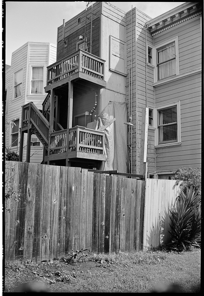

Just in case anyone is curious, here's one shot from the lens-
This is on a Horseman VH. It turns out that I had the lens swung a bit to the left from a previous session and didn't realize it. So you can see a touch of vignetting on the upper and lower right corners from this swing (maybe 3 degrees?). Later shots after I corrected this do not show the vignetted corners. I'd say that the lens just barely covers 6x9. Sharpness holds up well, dropping off only in the 2-3mms at the corners. I have a 6x7 back, so if I use this lens on any regular basis it would be at that format. All in all I am pleasantly surprised that it covered out as far as it did. I didn't see anything amazingly special about this lens compared to other large format lenses I have in this preliminary test with an erratic shutter.
An interesting note: the blurred shapes at the bottom edge are the focus knobs on the Horseman. I use a Schneider Super-Angulon 75mm on this camera all the time and have never had this problem. If anyone can describe or link to an explanation of this difference between focal length and 'image center point'???, much appreciated.

The red and white dots on the side of the front standard are used as a marker for the minimum rise needed to clear the image of the focus rails when using 75mm lens in portrait orientation. (Page 17 of the VH-R manual). If you don't want the rise (or have no image circle for rise) then use the side tripod mount and flip the back. If you like that focal length, I can highly recommend the Topcor 75mm lens. I think it is one of the sharpest in the Horseman 6x9 lens range.

ic-racer, I use the 75mm Super-Angulon without raising the lensboard in portrait orientation all the time. Go figure...

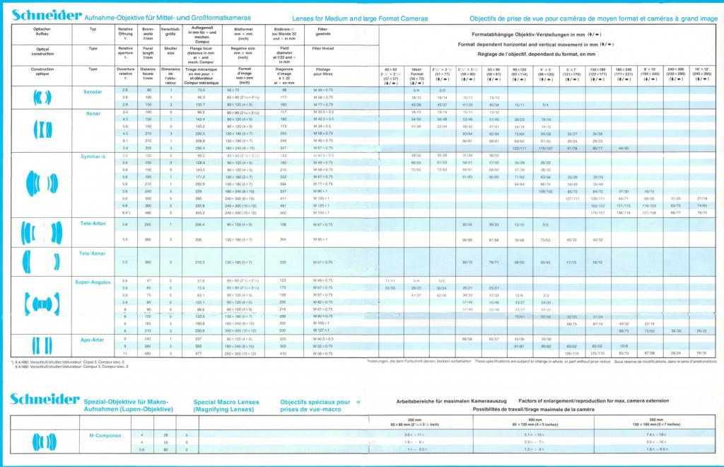

Interesting observation. Perhaps due to lens construction. The Super Angulon 75mm has a back focus distance of 85mm whereas the Horseman/Topcor 75mm has a back focus distance of 73.7mm. Schneider literature also lists the back focus distance for the 80mm Xenotar at 73.5mm. So basically the SA sticks out more than the Horseman/Topcor and Xenotar, when focused at the same distance. So, you have observed it sticks out enough for the image to clear the focus rails. Back focus is determined by both the nodal points and how the lens barrel is mounted in the shutter. Since angle of view of the two lenses would be similar, I suspect the nodal point of the SA are farther apart with the front one being farther in front compared to the Horseman/Topcor lens.
Anyway that [using the Xenotar on the Horseman] is a neat experiment. I always wondered what a Rolleiflex would be like with movements.
BTW the Schneider literature also lists 56mmx72mm (nominal 6x7 format) as the covering format for the Xenotar 80mm lens with 3 to 5mm of movement.

ic-racer, thanks for the discussion of the back focus distances, etc. I knew there was a language to describe what was going on but I couldn't remember it.
Your comments got me to drag out the bookmark to the Schneider site where I assume you were getting these numnbers? If they are from another plalce, it'd be great to know. Anyway, the Schneider site-
http://www.schneideroptics.com/info/vintage_lens_data/large_format_lenses/index.htm

This lens brochure used to be on the Schneider site. Don't know if it is still available there. The cameracentric website also has a number of Schneider PDF files.

Well, Dan, all I can do is look at the images I made. It was only one roll, and the shutter was new to me and its times were off. But I did get image to the corners. As I said, it lost sharpness at the edges. maybe 2-3mm in on the corners. to me, that is NOT coverage of 6x9. There are so many 75mm lenses out there that can give you clean corners at 6x9, and provide for movements. If I am going to mess with a 60 year old lens, there had better be a reason. The combination of blurred corners, no movements, and nothing about thelens screaming 'special' means I won't be using it much. Truth is I don't like the 6x7 format so I doubt it will see use there, either (please, no need to argue how great 6x7 is- I see people do great things all the time, it's just not for me).
I wonder if your lens was set up for 'traditional' view camera type mounting. For the Rolleiflex, there is no need for a filter ring on the front and any protection on the back. The glass itself projects beyond the metal mount for both the front and rear group. The Rolleiflex body and lens shroud add depth. Maybe the extra metal for view camera work adds a bit of shading?
