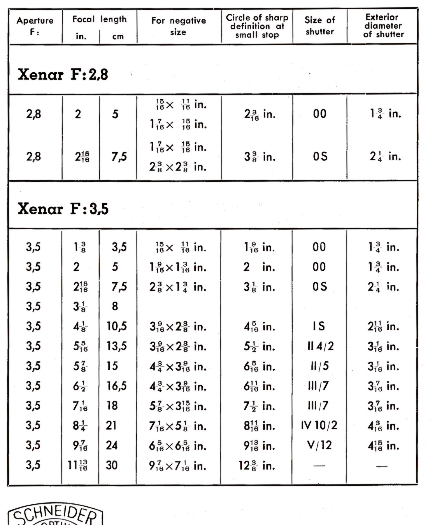

I wouldn't hold my breath hoping for 8x10 coverage...
Viewfinder mask 3 or 4 will work; 150mm is right on the edge of coverage of each.
You must be mistaken, barely 4x5".

Just curious, can you see the text "Typ D" written anywhere on the lens?
I don’t think so but I’ll check when I get home. I wonder if that chart might not include the version I have… seems very clearly to be a large format lens, very substantial and set in a big Copal #1. Maybe not 8x10” but it would be surprising to me if it didn’t cover 4x5”. As soon as my lens board for #1 shutters comes I’ll see if vignetting appears on the ground glass.
It will do fine on 4x5 Graphic, if that's a FL that meets your artistic intent. You probably not going to be using much in the way of movements anyway. That table may have conservative format size numbers.
It will do fine on 4x5 Graphic, if that's a FL that meets your artistic intent. You probably not going to be using much in the way of movements anyway. That table has exceedingly conservative format size numbers.
No, it has only the text “Xenar f:3,5 F=15cm D. R. P. Schneider-Kreuznach no.(s/n)” around the rim of the front cell and nothing on the rear cell. No red V that would indicate coating, and it certainly appears uncoated.

Xenars are 4/3 tessar types. Tessars to not have a lot of coverage for movements. I have a later Xenar 150/5.6 which has a little space for movements, and a 210/6.1 which has a good amount. Usually it seems like the faster tessars (like 3.5) are more limited in coverage.
