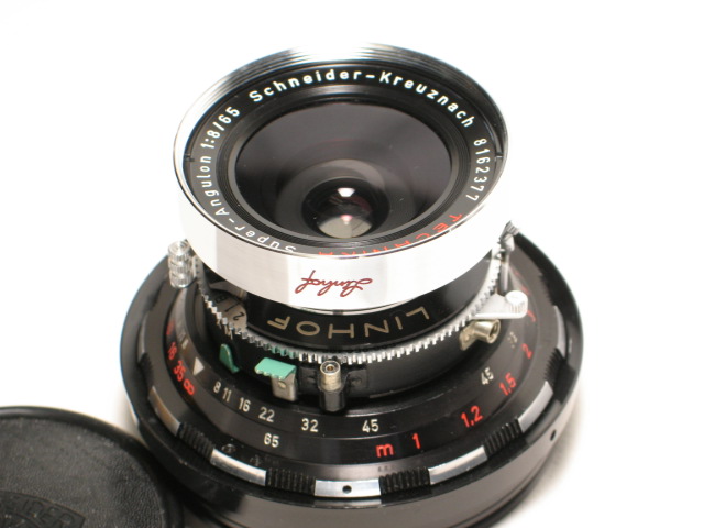

hi, i am looking at this lens for a 4x5 camera, no movements whatsoever. i know the regular schneider super ang. 65mm f8 does not cover 4x5 but i cant find any info on the technika version of the lens, is there any difference in coverage? ive looked all over and am going crazy becuase its like specs for this lens dont exist.

The 65mm f8 SA does cover 5x4 just, I've been using one for about 20 years. However according to Schneider it covers 9x12, but then their technical data is only given in Continental European sizes not UK/US.
Mine's a Linhof select version, there's no differences other than Linhof were able to pick based on their own tests.
Ian

I have one as well and can confirm Ian's post. It just covers 4x5", and the only attraction of the Technika labeled one is that it was tested and selected by Linhof, and was at the time of the test possibly better than other examples of the same lens produced at the same time.
If you are lucky, you may be able to find the original center filter for this lens. It does exist, but it was years before I saw one come up for sale. There is probably a generic center filter from Heliopan that you could use instead, if you wanted one.

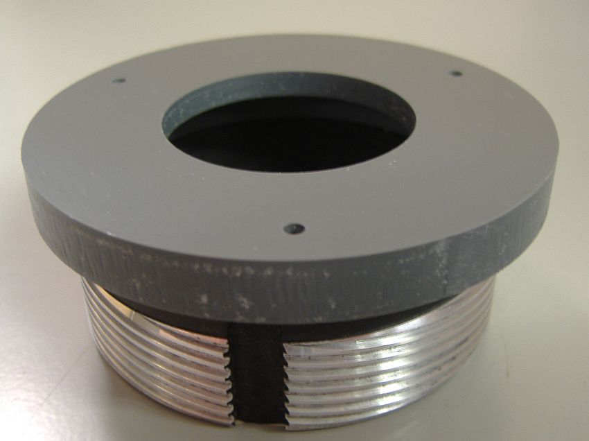

Mine has the smaller shutter which I have to send away for repair as one of the shutter blades fell out. This could be an advantage for you as it means I can take some pictures of the modified Olympus lens for you to look at and compare with yours.
I bought the Olympus lens on the recommendation of someone else who had done the same thing but it turns out that mine was not the same as his and it was easier to convert mine. His needed extra light-proofing and I think he had to reverse the helix whereas mine stayed as it was built.

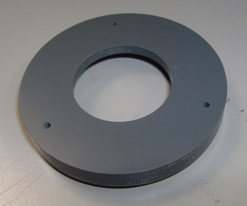

I think you should just take it apart slowly and see what you are left with. You should end up with the half of the lens closest to the body mount (which you remove) then there is a bit of metal cutting and filing and you will need to make a lens board which mounts on the helix.
If you look at the last picture on my page you will see that all you are left with is the bit encased by the focusing ring.

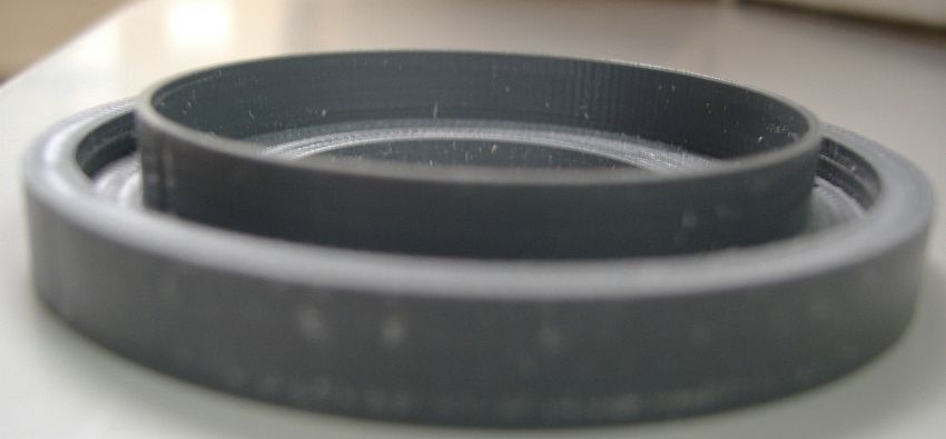

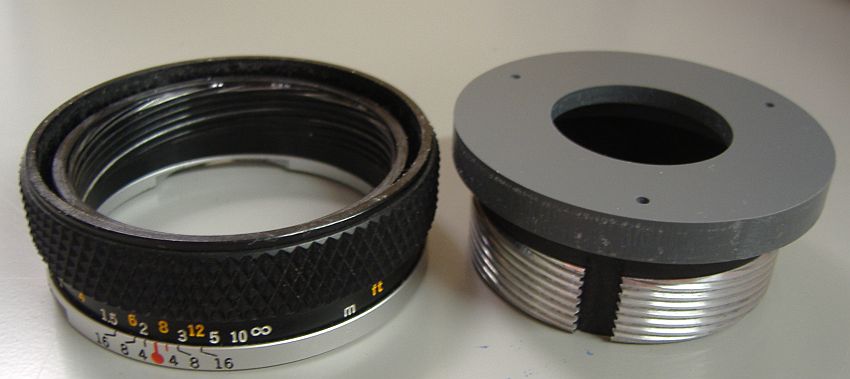

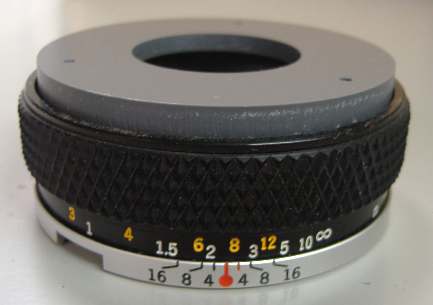

I have attached some pictures of the parts I used. As you can see, there is not much of the Olympus lens left!
Steve.
