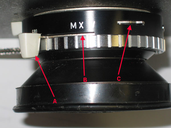

I hope enough of you will bare with me on a couple of novice questions about this lens. It was acquired along with a fairly extensive Cambo outfit as my first attempt at LF photography. All prior experience was 35mm.
I have no documentation for the camera or lens, so I have been learning as I go. I thought I had everything set to go and was contemplating trying a couple of shots after going through the film loading routine, etc. I gave the lens/focus routine one last go-through and discovered that at any shutter speed below 1/30th sec., the shutter hangs open. Above that, it closes as it should.
What I have been doing, is with the shutter uncocked, I use "C" in the accompanying attachment to manually open the shutter for focusing and is closed manually before cocking the shutter? "A" is to cock the shutter prior to taking the picture. One of the things that puzzles me are the M X and V. "M" = Manual? "X" = x-sync and "V" = no clue. What are they, how do they come into play?
As for the shutter sticking below 1/30th is this because of something I'm doing in the wrong sequence, or a faulting lens/shutter. If faulty, is this lens worth taking someplace for service. I have no idea how long this may have sat unused before I acquired it.

These shutters get lazy if the slow speeds aren't used. It'll probably need a CLA.
You're right C is the preview lever. The MXV bit I've never fathomed out except the X is flash sync for electronic flash. Older shutters particularly US, Illex etc have an adjustable delay for different flash bulbs.

M= Bulb sync, X= X-sync, V= delay (timer, from "Verdauer").
The shutter is well worth a cleaning. What the lens is worth is irrelevant, just compare the cost of a new shutter with a CLA.

Hmm, guess I'm confused. How do these (MX,V) come into play? I have to depress the shutter all the way to the "V" end before the shutter is cocked for anything. Or, is this another indication that this lens needs either to be serviced, be relegated to paperweight status.

There should be a little lever to switch from M to X to V...

This one definately does not have such a lever. I now just noticed that if I set the shutter speed to anything below 1/30, the shutter hangs open, but if I either gently tap the lens board a couple of times it closes, or if I slowly turn the shutter speed selection ring clock-wise toward higher speeds after it sticks open, it will close when I reach about 1/125th.

I've got two older Schneider lenses with similar Synchro-Compur shutters.
The one with a 135mm Symmar-S has no MXV markings, and I know its flash synchronization is X, since it works fine with electronic flash.
The shutter on my 75mm Super Angulon has the MXV markings just like your lens, but it also has the little three-position lever which allows you to select which flash synch (or self timer).
At some point in time, the M synch was omitted due to flash bulbs falling out of favor. I'm guessing that your shutter is X synch only, and that the manufacturer had some leftover parts with the MXV designation and didn't want to waste them, confusing though it might be!

I'm back again. I probably committed some form of heresy, but after finding no one who could turn around servicing my lens in less than 6 weeks, I took matters into my own hands. I wanted to take the gear up to the U.P. on vacation in August and 6 weeks just wouldn't cut it.
Using a short length of very thin wire with a drop of very light oil on it, I maneuvered it into various openings on the lens front (cocking lever, shutter tripping lever, etc.) and tried to get the oil at points of pivot or friction that could be reached. Worked all the shutter times a couple of times (still sticking below 1/30th) and then put it aside overnight. Next day... all working fine. Even "bulb" is releasing properly after letting go. Is it calibrated and are the shutter speeds correct? I have no idea, but wouldn't have known had the lens been functioning when I received it since I knew nothing of the history. I'll try some rudimentary testing and comparisons though, which had to be done anyway.
