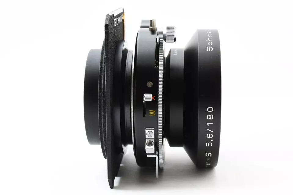

Does anyone know what the little lever on the Copal 1 shutter marked OFF-M is for?
(Just into Large Format so a bit ignorant of the gear)
Thanks.

Shutter do vary. Newer shutters are usually only synched for electronic flash and don't have a switch. Older lenses are sometimes synched for flash or bulb, and have a switch USUALLY marked X (for flash) and or M or B (for bulb). Yours is probably an older shutter marked M (for bulb) and OFF (for flash). I've never seen that designation, but someone else will jump in and confirm what I've written -- or tell me to jump in a lake.

Whatever it is, it's not going to affect the shutter speeds. And since it's an older shutter -- have any idea? -- have you tested the shutter speeds? Do they sound OK, anyway? Can you send a photo?

Herewith showing that little lever.

Honestly..its an age thing (91)..
.I should have said the lever is marked X-M NOT off-M.
Which makes more sense now...my fault..should wear my glasses...🙄

X is for electronic flash, and M is for bulb flash. The lever is covering part of the X, which makes it appear to be a v in the photo.
