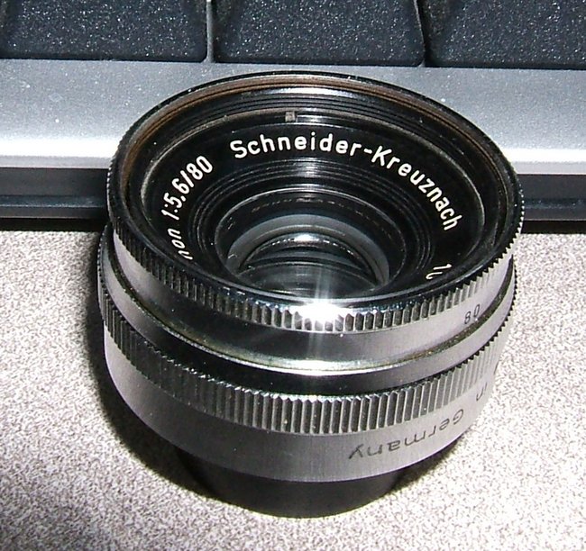

I'm looking at buying an enlarging lens for my Beseler 45MCRX. The one that I see is a Schneider Kreuznach Componon S 80mm f/5.6. The problem that I'm trying to get out of the person is how big the threads are on the back. I need an 80mm lens that has the 39mm threads on the back that uses a jamb nut to hold the lens against the lens board. If anybody could help me out, that would be awesome. Thanks!

I have an 80mm Componon S and I am 99% sure it is 39mm thread. I would have to go and check it to be 100% certain.
It screws into an adaptor disc about 2" wide to fit my LPL 6700 enlarger.
I will have a look tomorrow morning and post my findings if you have not received a definite answer by then.

thanks for the link. It says Leica thread. Is that the same one that I'm talking about? The lenses that I use now are the 50mm from a beseler cadet II and a 135mm f5.6 nikkor. They both attach to the lens board using the washer/jamb nut on the other side. Thanks!

Well.. I said I was 99% sure. Unfortunately, it was the other 1% that was true.
The link Ole posted gives a thread of 25mm for the 80mm Componon and that is what mine looks like. It is in an adaptor which takes the thread up to 39mm though.
My enlarger came with the adaptor but no lens so I would imagine that a 25 to 39 adaptor is fairly common.

That looks exactly like the one I have.

It looks to me like 39mm. We have several componons and the older ones are 25mm, the newer ones 39mm. I strongly suspect that this is 39mm from the photo on the auction. There are 25mm beseler boards out there if you need one.

The older 25mm ones are made of chrome metal (see pic) , I think that this is a newer plastic model and is probably 39mm. You can find 25-39mm adapters on Ebay cheaper than the one from BH. You have to look though Ebay store items, they are usually listed in there. I think I paid around 10 bucks for 3 of them.
