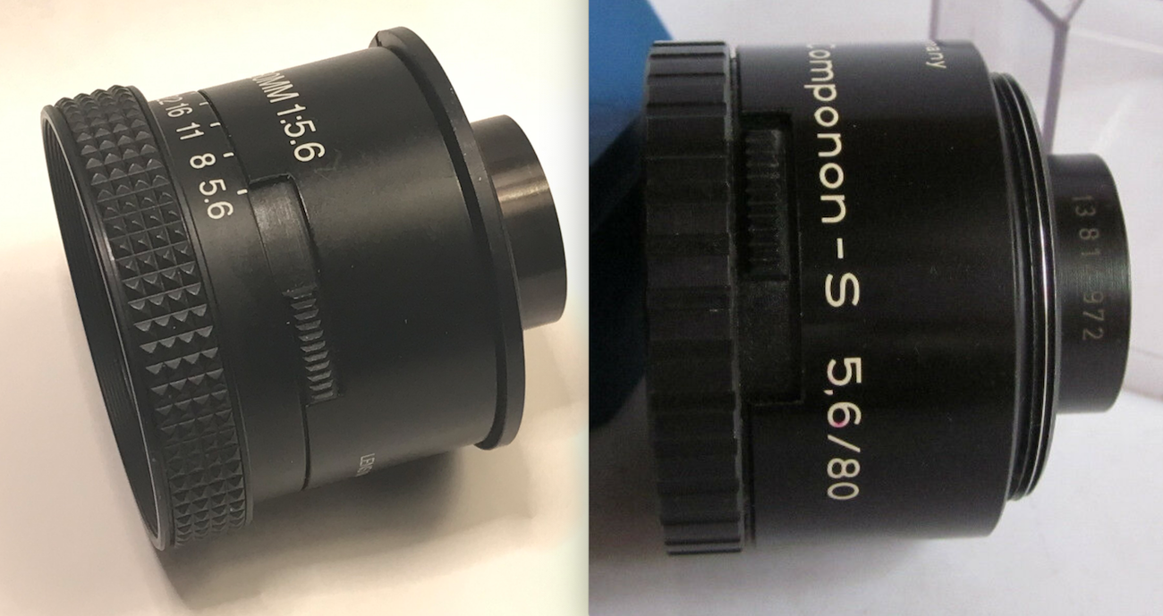

Jul 15, 2012
Investigating this lens, FWIW, it appears that the 80mm f/5.6 Vivitar VME enlarging lens is identical to the Componon-S.
