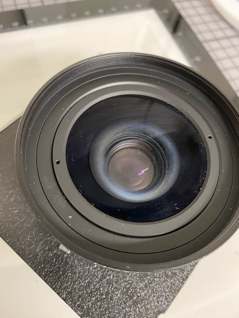

I dug out one of my old unused lenses: a Schneider XL 4.5/80. One of the internal front surfaces is covered in a white mist. Any idea what this could be? Is it repairable? Or am I right to assume the lens is now useless?

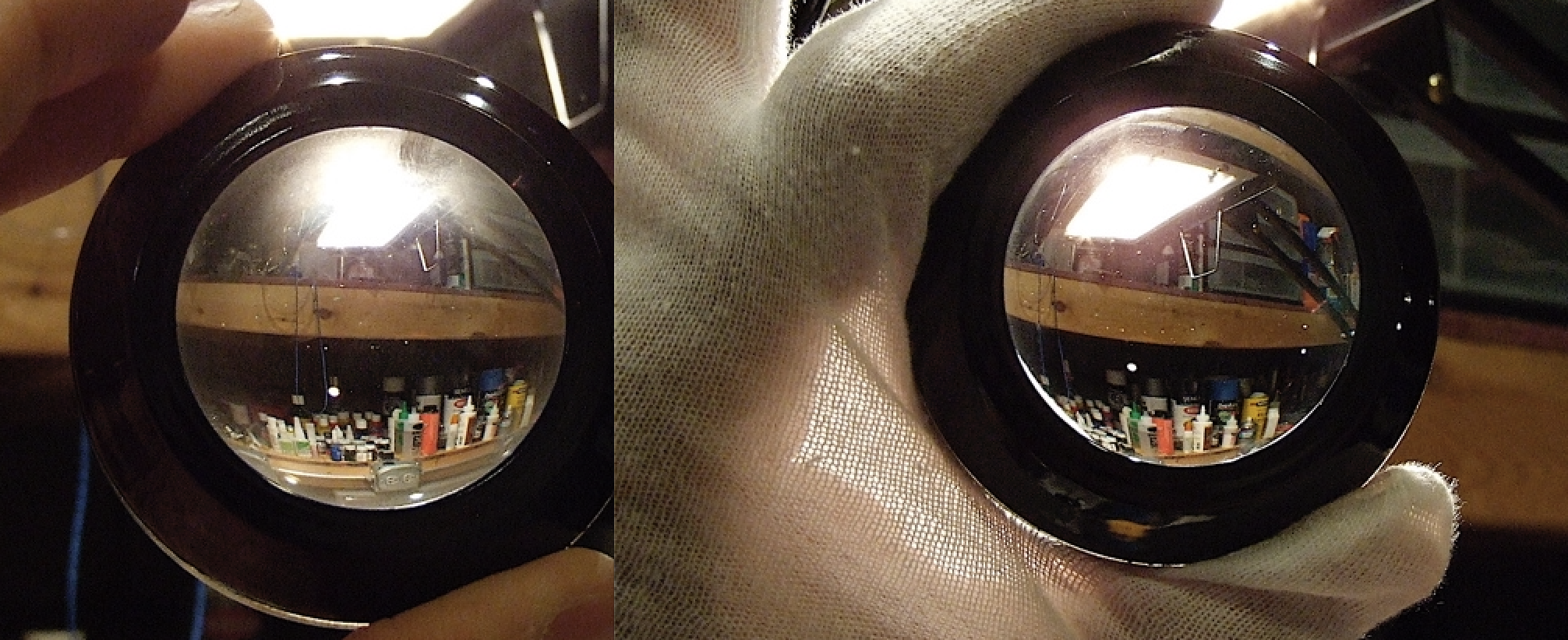

I'll guess that is permanent, but you might be able to reduce it somewhat like this:

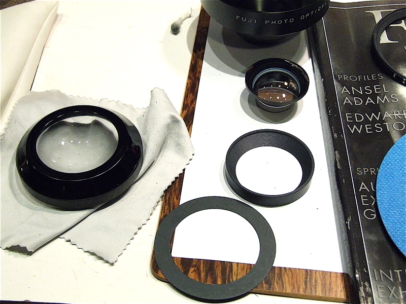

Try tapping in on the workbench, I think the elements should come out.
This is the Fujinon Superwide shown above. There were just two groups (the rear being glued together) and the fog was behind the front element. Your superwide might be similar.

Thanks, but no. It's been in the same moderate climate for the last 2-3 years
