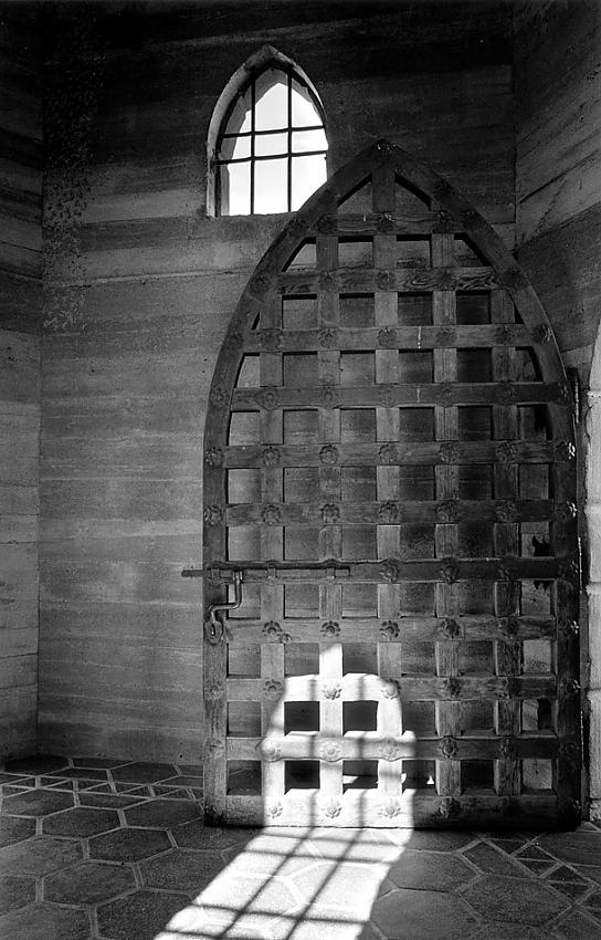

This is a straight print at Grade 3 with no burning or dodging required. I used the recommended meter setting and just got lucky with the lighting I had:
full
This print required quite a bit of dodging/burning and split-grade printing. Everything from Grade 4.5 for the door to Grade 1 for the sunlit highlights. I metered for the door and figured I would try to burn in the highlights in the darkroom. As a straight print it was very flat and all the highlight areas were completely blown-out:

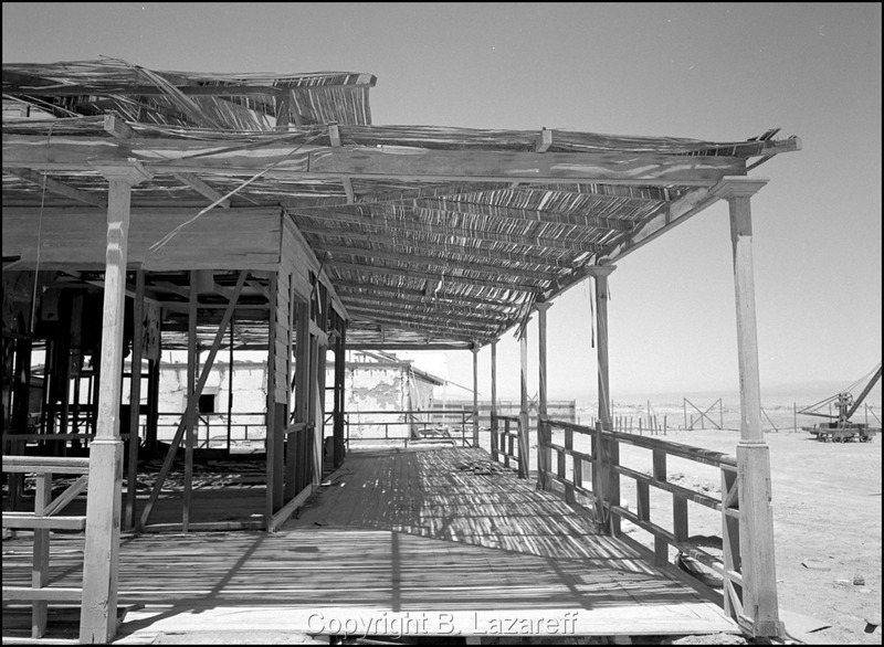

Example:
Nov-2013. Nitrate mine at Chacabuco, also a detention center during Pinochet years. GS645W. Neopan 400. D-76 1+1.
Another point. "Expose for the shadows" is broadly correct but over-simplified and slightly over-done. In the above example (among many shot using same method), Neopan400 was rated at 250 nominal; open shadows (general average thereof) was placed in ZoneIV, or, in plain language, I took a reading of open shadows, and closed the shutter one stop. The negative is nowhere near over-dense and prints without dodging. This is my usual method for mixed sun/shade scenes. Of course, do not apply to deep shadows, that are subjectively black and should be rendered the same.
