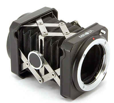

xkaes
Mar 25, 2006
4,515
Colorado
My Minolta Compact Bellows is 40mm when collapsed, and I don't know of any shorter than that.
