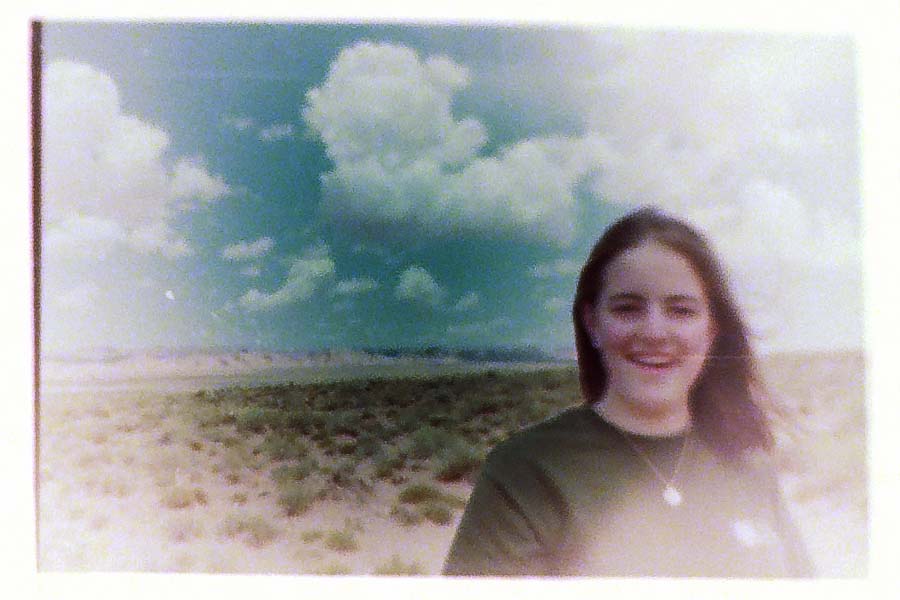

I might be tempted by this technique if I had all the slide copying and macro gear myself. I made a stab at this in a much more redneck fashion using my cheap Zoom-Nikkor and lightbox. I found the following:
You need to shield the lens from all extraneous light (I made a tube and taped around the frame on the lightbox). Your bellows and slide copying attachment would take care of all of these considerations.
The next consideration relates, I think, to the problem you are having. The problem is the "white balance" mindset. Colour negatives have a large imbalance between the channels. Digital colour balancing is just a matter of boosting the weaker green channel and much weaker blue channel. This is far from ideal. If you are ending up with a colour cast you cannot easily get rid of the most likely explanation is that you are clipping one of the colour channels. Red will be very easy to clip on the highlight end (which become your shadows when inverted). Blue will be easy to clip on the shadow end (which become your highlights when inverted) because it is so weak. Especially on a Canon since Canons are tuned to give those deep inky blacks.
My suggestion is to set a "daylight" white balance and obtain an even exposure for all the primary colours by using actual screw-on colour correction filters. If you do it this way you will be able to obtain a full-range exposure for all three colour channels on the sensor and much more easily prevent clipping any colour channels.
The difference with a scanner is that it will automatically set different exposures for the different colour channels when used in the "negative" scan mode. On many scanners you can also take manual control of this such as the Epson, the Konica Minolta software and the Nikon software. On the DSLR all colour channels are exposed together by a single shutter so you either need to balance the channels with coloured filters or take three black and white pictures of the same film through three primary colour filters and combine them in Photoshop.

I've never seen anyone do a good job of capture with colour negative on a DSLR but you may be the first. Primary problem seems to be the lack of signal you get in the blue channel. Perhaps if you could tailor your light source to suite? Dunno
Pellicle, read my post. I was addressing that very issue. Since you can't vary the exposure per channel you need to either make a filter pack to neutralise the colour imbalance or use filters to take a properly exposed photo of each colour channel.

I hope we are all trying to help OP as well as anyone else who finds the thread later. The reason I didn't think you had read my post or had read and didn't agree was that you said the primary problem was the lack of signal in the blue channel and my post directly addressed that issue in terms of using a DSLR.
In fact, here is a not-totally-horrid result I got that way with afor-mentioned lightbox and sticky tape setup:
http://www.flickr.com/photos/samagnew/4713716315/
and another here:
http://www.flickr.com/photos/samagnew/4714351622/
The second one shows some of the light-leak problems I was having. A bellows and slide copy setup would eliminate such issues.

quite good ... is that full frame or in tighter?
The camera was my trusty ol' D80. My only DSLR. The lens was the Zoom-Nikkor 35-105 "Macro" that came with my Nikon FE mounted on a reversing ring. This gave me the ability to adjust the position of tripod, light box etc. until I had one 35mm frame filling the viewfinder. I made a black paper mask on the light box with a 35mm frame sized window in it. I found I also had to make a tube of black foam and shoot through this "tunnel" because so much stray light came in from the sides.
This would be much easier with bellows and copier attachments. The key to a good result is getting a good exposure of all the channels by optically filtering the negative rather than relying on software.
What else? I don't have Photoshop so my raw file was imported as a gamma 1.0 tiff by PhotoLine. The negative convertion was with the ColorPerfect plugin using the ColorNeg module.
No ICE but with a better camera and better setup I can see this cranking out some very good results much faster than scanning. Since I don't have the right stuff and I do have my 9000 I haven't experimented any further with it.

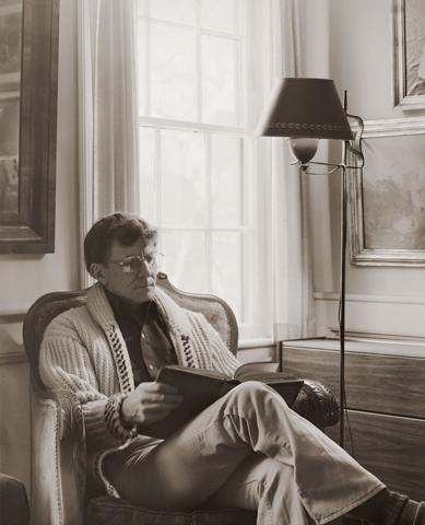

Years ago, I set up my Canon D30 on a copystand and used it to proof and digitize sheet film. Today, I use a Nikon D700 for both sheet film and roll film, and haven't touched my film scanners in over a year. I recently made a large palladium print from an old 35mm TX negative and pulled several tricks from the hybrid bag to make the picture I wanted:
1) I made an enlarged 6x9 image on a sheet of 8x10 film.
2) I copied the enlarged positive with the D700 with a 60mm Micro-Nikkor.
At this step, it was easy to record detail from the original negative (that no scanner that I could ever afford)
3) which made a digineg that held the lovely, crisp, Rodinal grain and printed easily
My light source for 4x5 and 8x10 film is a homemade plywood box with a 'old' Omega color head inside.
For roll film, I use a Beseler duplicator.
AS for technique, what David said.
It is easy and a pleasant way to work .
(unlike scanning, which has never, in 20 years, has ever been fun)
Here is a typical proof of a 4x5 image that takes advantage of the RAW potential of current DSLRs and software. Good proofs, and easy.
