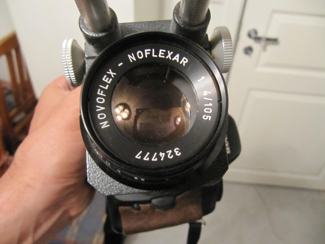

so I thought of either buy the Reflecta RPS 10 wihich processes full rolls, you feed it and do something else/go to work/etc. But it's costly, here around 10.000 NOK. I wanted to try DSLR scanning. I have one DSLR left, that I used once in the last six months, a Canon 5D. No not the mk IV, mk III not even mk II, but the first one Mark I, 12,8MP sensor. Of course there''s no liveview, focus peaking nor whatever fancy, it's for taking pictures with your eyes. I use it with M42 lenses moreover.
It happens I had around from I don't know where a M42 bellows with a Noflexar 105mm/f4.

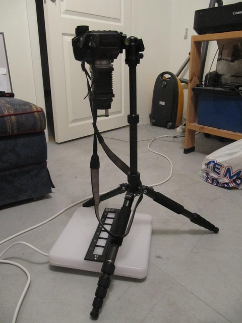

this is the setting:

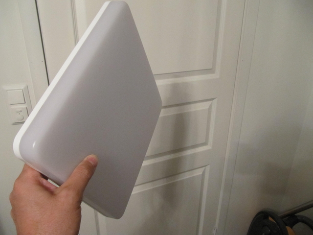

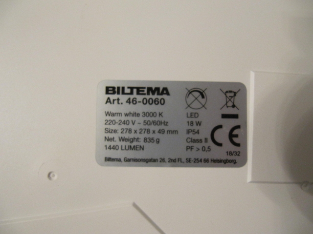

- a cheap LED lamp bought from the hardware store around:
- a regular tripod
- film holders, the Digitaliza ones I use on the Epson for 120 and the Reflecta 10T ones for 35mm
so, the 5D leveled on the tripod, with the bellows and Noflexar lens. Here a Reflecta 35mm holder is on the lamp:

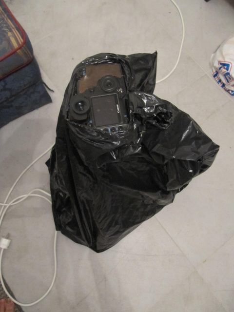

I shot with 2s self-timer or cable, with light shut down in the room and a dark bag over:
this was just for testing. For regular use I will make a board with holders or holes for the tripod and lamp, set markers on the tripod and bellows for the focus for both kind of film, and rails for sliding the film holders on the lamp.

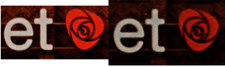

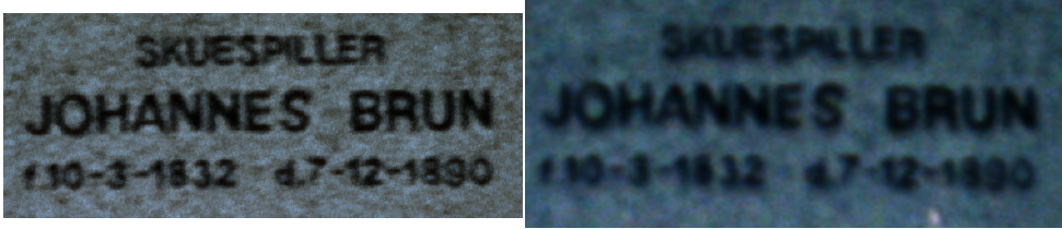

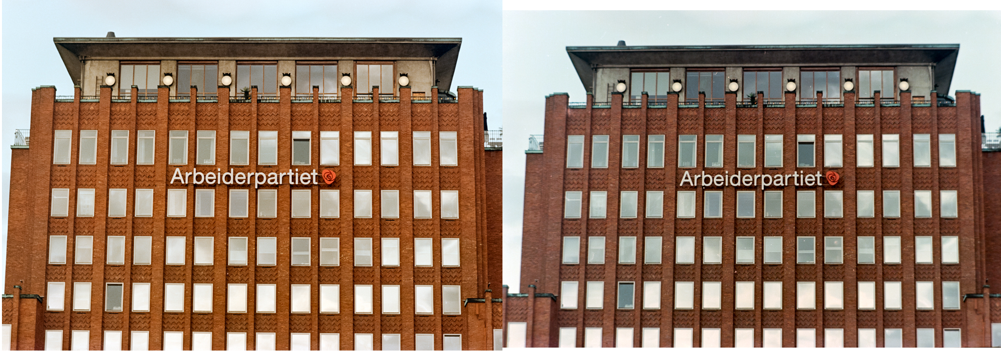

couple more 24x36 scans. I picked a strip of Ektar. The Reflecta-10 @4100dpi has an edge over the 5D, but not so much.
Sorry, these are heavy pictures, side-by-side jpg of whole frames and side-by-side detail crops in png from the original tiff (out of the raw).
Reflecta-10 on the left, Canon 5D on the right:
have printed the Engebret picture scan with the 5D on A3 and it's ok to hang on a wall yet a bit soft.
I found around here couple guys renting a 5Dmk2, will try one, I guess it should outperfom the Reflecta-10 scanner... The old 5Dmk1 is acceptable for web or small prints
