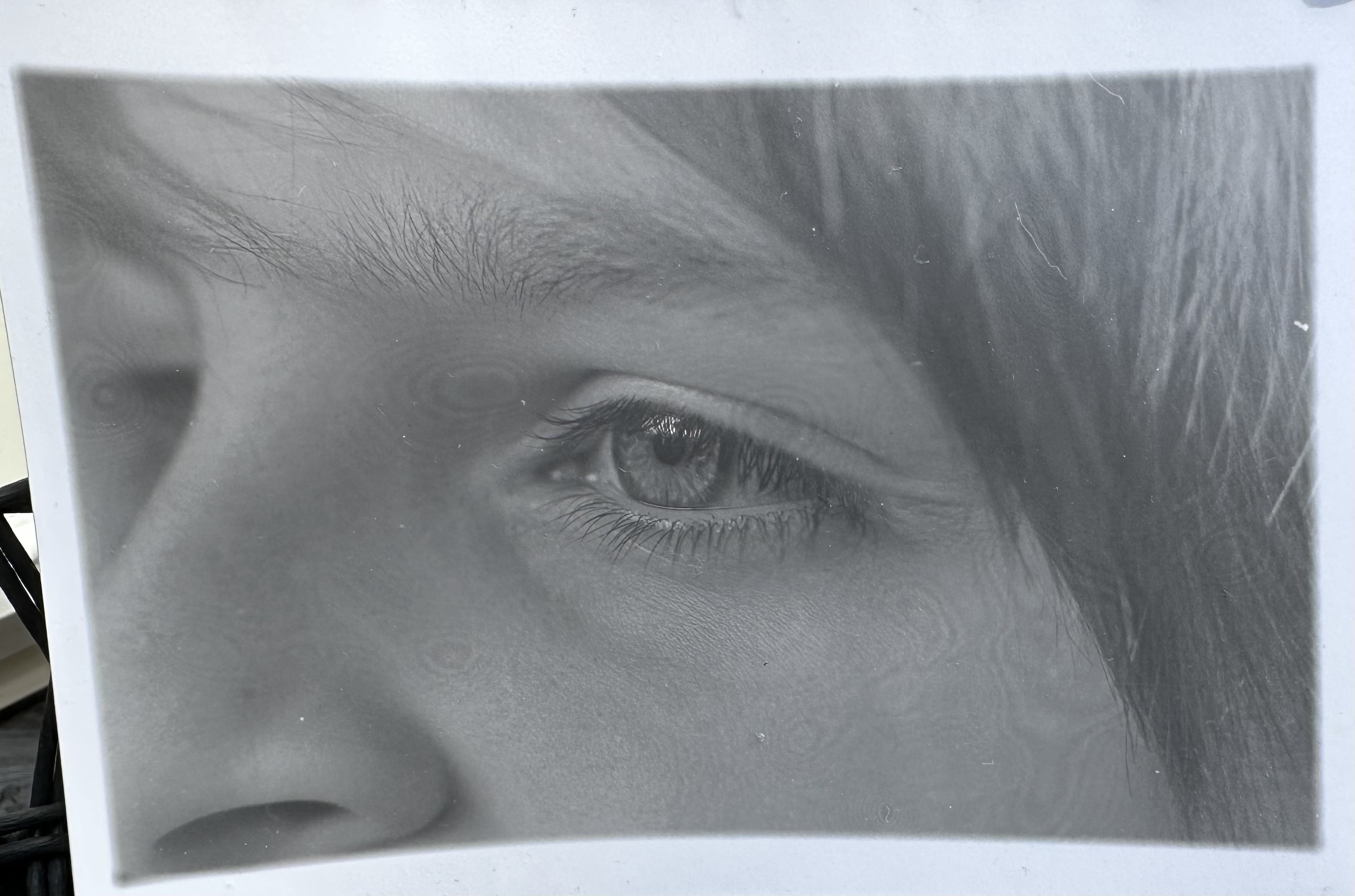

It printed OK, but a little flat. I also tried printing a couple that came out better in the development, they were easier. I do uave dust issues though… and some water marks one one if the negs. Oh well…

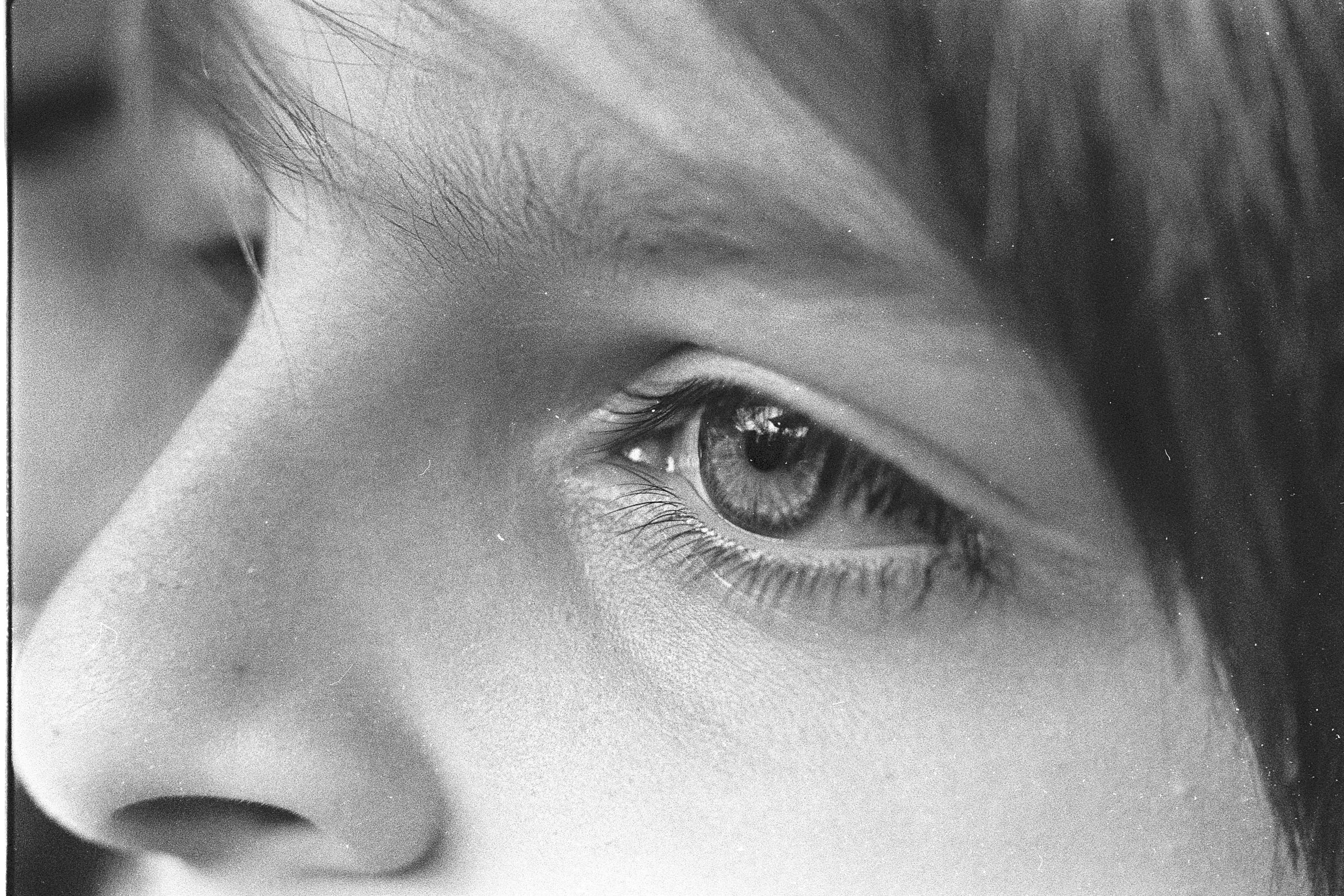

Compared to the scan. My developer is getting ild too, so maybe the print could have come out better.

Could the print have come close to the quality of the scan if I’d exposed the paper less, and run it through the developer longer, or with higher concentration?

a little flat.
Indeed, there are no real blacks in your print. What grade did you print this at? If you can go higher, it's worth a shot.
Btw, it's debatable how deep the blacks need to be in a print, especially a portrait. To a large extent, the eye adjusts to the density range it's presented with and accepts it as normal.
I mostly see severe newton rings in your print. Are you using a negative carrier with glass, and have non-AN glass installed? Is this what you may be mistaken for 'water marks'?
Always develop paper to completion! Depending on the paper and developer used, this is between 1 and 4 minutes, most of the time. Very concentrated developer on RC paper will develop to completion in a minute, with FB paper and concentrated developer usually 1m30 or 2m00 is allowed, and anything upwards depending on developer activity.
Never pull a print from the developer 'because it looks good right now', unless you're lith printing (and you're not) or you have a very specific purpose in mind (not applicable here, it seems). If your print comes out too dark when you develop to completion, give less exposure. If that makes the contrast too low, increase contrast grade. If you print at grade 5, develop your paper to completion and your prints are still flat, you're SOL and need to work on making better negatives :smile:

The paper is Ilford Multigrade IV.
Yes, it’s the Newton rings, I didn’t know what they were called. Yeah, negative carrier with glass, but I have no idea what type of glass is in there, it’s a pretty cheap enlarger.
Ok, with RC paper and paper developer diluted to the instructions on the package, usually development times will be 1 minute to 1m30s minimum.
You need anti-newton (AN) glass at least for the upper sheet of glass. With 35mm you could try just leaving out the upper glass plate and see how that pans out; with roll film, just the lower sheet is often enough, depending on the construction of the negative carrier. With some films, the lower glass plate (on which the emulsion-side of the film rests) will also have to be AN glass; in particular TMAX films and most Kodak color films tend to have such a smooth emulsion side that newton rings can occur.
For small/modest enlargements from 35mm film, a glassless negative carrier is usually sufficient and IMO less cumbersome for several reasons. The availability of such a carrier depends on the enlarger type.

From my selfish point of view there is nothing like a straight scan of a darkroom print when it comes to telling those of us who only darkroom print how a developer-negative-print sequence has worked such as your experiment with Rodinal stand development and its ability with increased film speed
pentaxuser
Yes, the lower dilutions certainly produced denser negatives, and might be more suitable for pushing film. I liked the scan of the face with the eye, but it might be difficult, at least for someone with my limited experience, to produce a good darkroom print. I am going to have one final go with Rodinal 1:200 before I give up on it for pushed development.

I might, might, have accidentally turned the negative upside down, emulsion side up. That could have produced more newton rings, right?
Newton rings won't form if between the emulsion and glass. The back of the negative against the glass produces them. So does that mean your negative holder is glass on the bottom only?
No, there is glass top and bottom, and the two pieces seem to be identical.

Why not use a glassless negative carrier?
